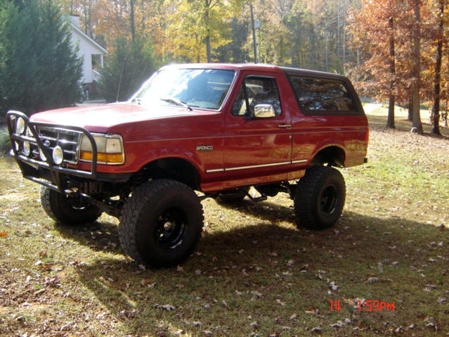

I know thier not the same, but after running 4.88's in my 95' Bronco with 35's and an E4OD auto with OD. It felt over geared and am just unsure about the 5.13's. I had an Aussie locker in the rear of the Bronco and ended up stripping the axle gears. That and the clicking and popping that come with them was irritating. Would, you not have the same issues with an Aussie up front unless you have locking hubs up front?
So, like like the majority say winch! This was my Bronco i traded in on the JK
