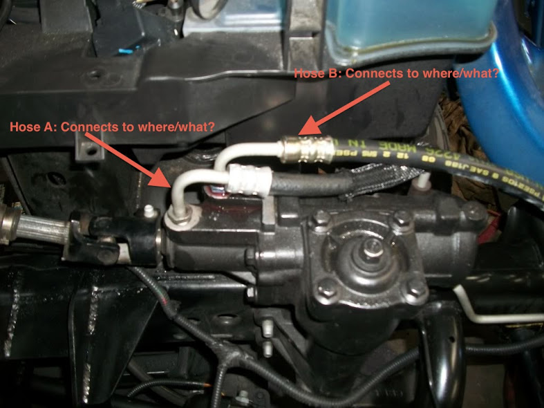

And one more question. So I've had mine apart long enough (and didn't label the danged houses)... which line goes to the pump and which one goes to the reservoir?
Name:	Power Steering Hoses JK.jpg
Old Dec 10, 2015 | 02:39 PM
  #40
Monte417's Avatar
Posts: 1,444
From: East Meadow, NY
A is the return line to your res. B is the pressure line that goes to your pump
