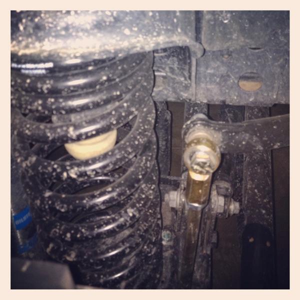

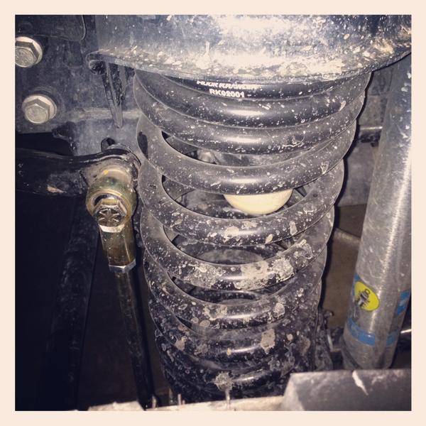

I love my 3.5" X-Factor System. Only issue I have had is with the front drivers side spring.
For whatever reason, The spring bows outwards toward and rests just barely touches the sway bar. I'm wondering if the fine people at Rock Krawler have any idea why?
I have flexed the shit out of it and tucked that wheel as far up in that fender as far as it can go and have had zero issues with performance...It's more aesthetic as far as I know.
Drivers side
Passenger side
Any thoughts??
Old May 2, 2012 | 07:29 AM
Rock Krawler Suspension's Avatar
Former Vendor
Joined: Jul 2008
Posts: 1,644
Likes: 13
From: Albany New York
Originally Posted by mpkelley20
I have a similar problem with my exhaust hitting either my track bar or sway bar. I run an aftermarket exhaust (Dynomax Rock Crawler). We tried various orientations of the track bar as well as the exhaust itself but looks like I will be cutting the pipe and have it dump underneath. In the pic below you can see how close it sits right now so I get smashing off the track bar. If I rotate the exhaust, it begins to hit the sway bar.
pic
Dam that exhaust is hanging down really low. Is that OEM?
RK
