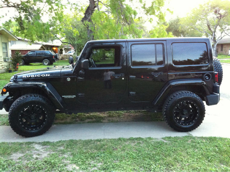

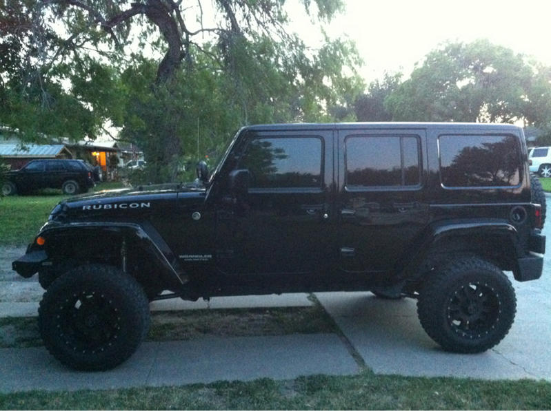

Ok so I just did mine today it took long but went great rk 3.5" max travel. I gained a good amount
Before and after.
Attachment 322939
Before and after.
Jeep looks really good. Now it looks like you're about ready for some new larger meats on that big guy. Hope your install was a smooth and fun as mine, now get that thing out and enjoy it.

I see you are running general grabbers ... How do you like those I just purchased a set but they are back ordered for a few weeks
Old May 29, 2012 | 06:44 PM
  #30
rb1boxer_3's Avatar
Posts: 665
From: corpus christi, tx
Tyler
Yea it was a bumpy long road my back and knees hurt still and I'm so sore. But it was awesome doing something like that. 37s are in the near future.
