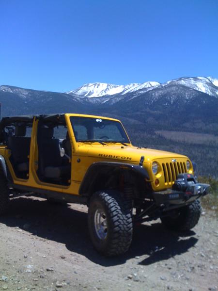

Save all the hardware you can, I've gone back and used mine at times (except the plastic hardware that holds the fenders on). I used the factory inner fenders trimmed, and a word of advice: go get a quality nutsert tool from home depot, sears, etc. It saves time and you get the inserts in better. And, if you ever plan on installing body armor or steel corner/fender combo, you will be glad you did, they attach with nutserts also. One other thing: the hard plastic front fender support: before putting it on, chamfer the top rear edge, then the top of the fender doesn't have a sharp "bump" on it, especially on hot days.
