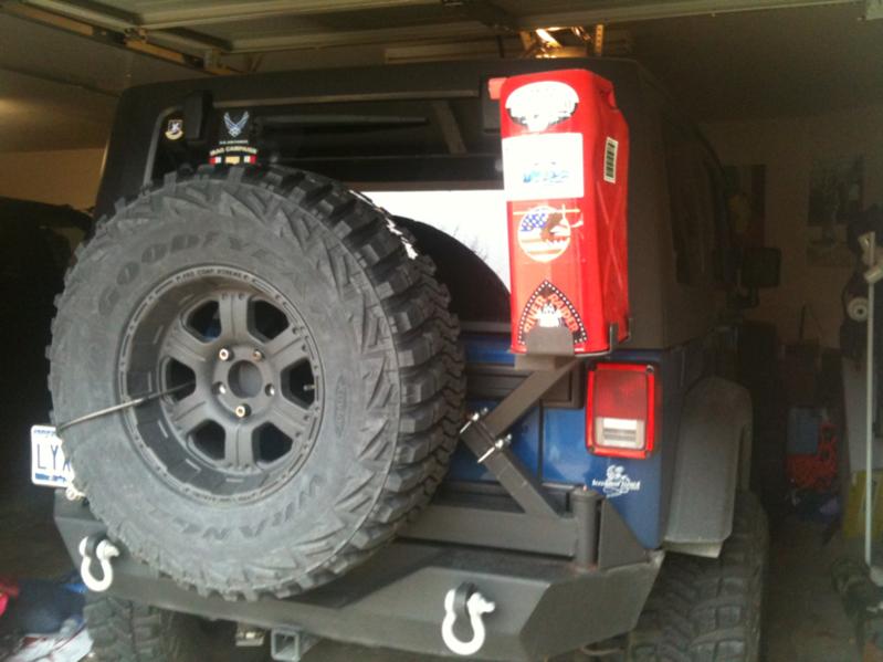

XRC; the original bugs are now fixed. The latch is tight, it's beefy and can hold other company's attachments aka Rock Hard Jerry can mounts. It's not the best, but for price it rocks!

Nice ride, Defender! Hua SF!
