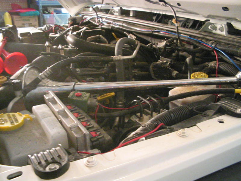

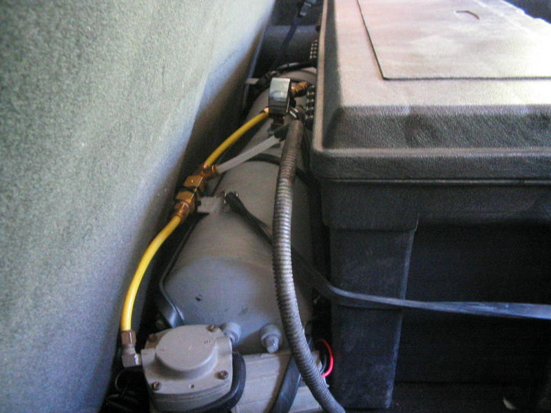

Old Sep 16, 2011 | 02:17 PM
mkjeep's Avatar
Posts: 15,665
From: Hammond Louisiana
ID:	211662Click image for larger version
24in grover fire engine horn, 6gal air tank, cheapo compressor.
