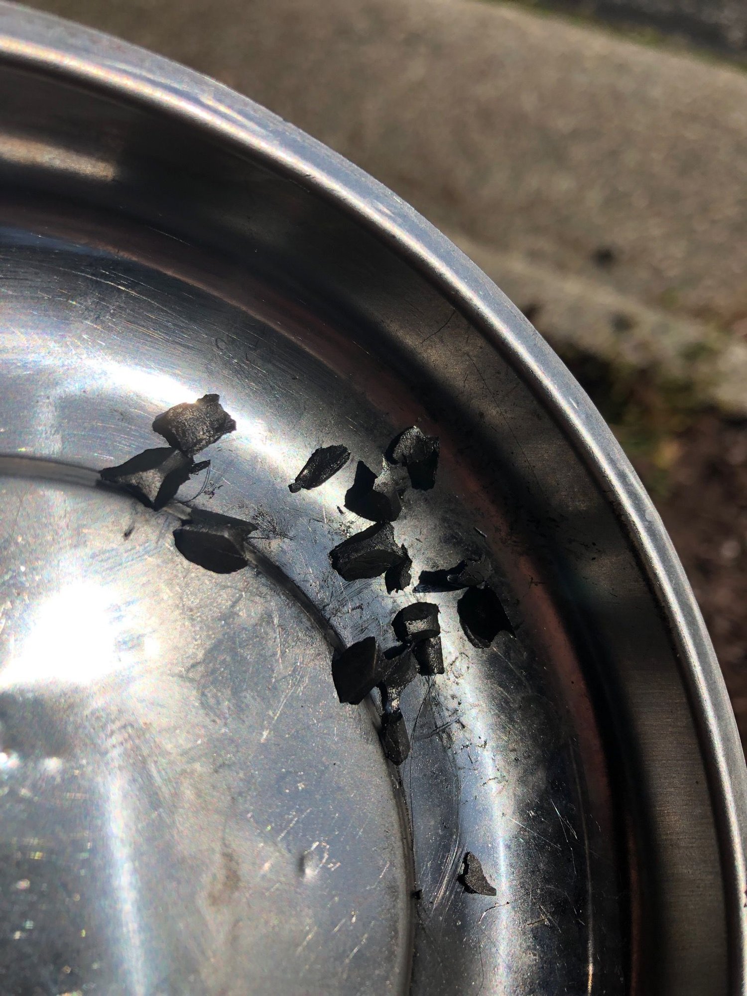

Hello everyone, I need some guidance. I'm about to replace the rear axle of my 2009 JKU 145K milles. About 3 weeks ago I replaced the gear oil in my rear differential. But when the oil started coming out, also did it metal chunks, specific gear teeth. I did not wanted to open the pumpkin and see the damage. I know shimming and replacing the gears, are a level that way is over my head, so I went online and got a used 2015 JKU 45K milles rear axle. I"ve been looking online for a video on how to replace the rear axle, but so far I don't have any luck finding one.

Metal chunks that came out from the differential.

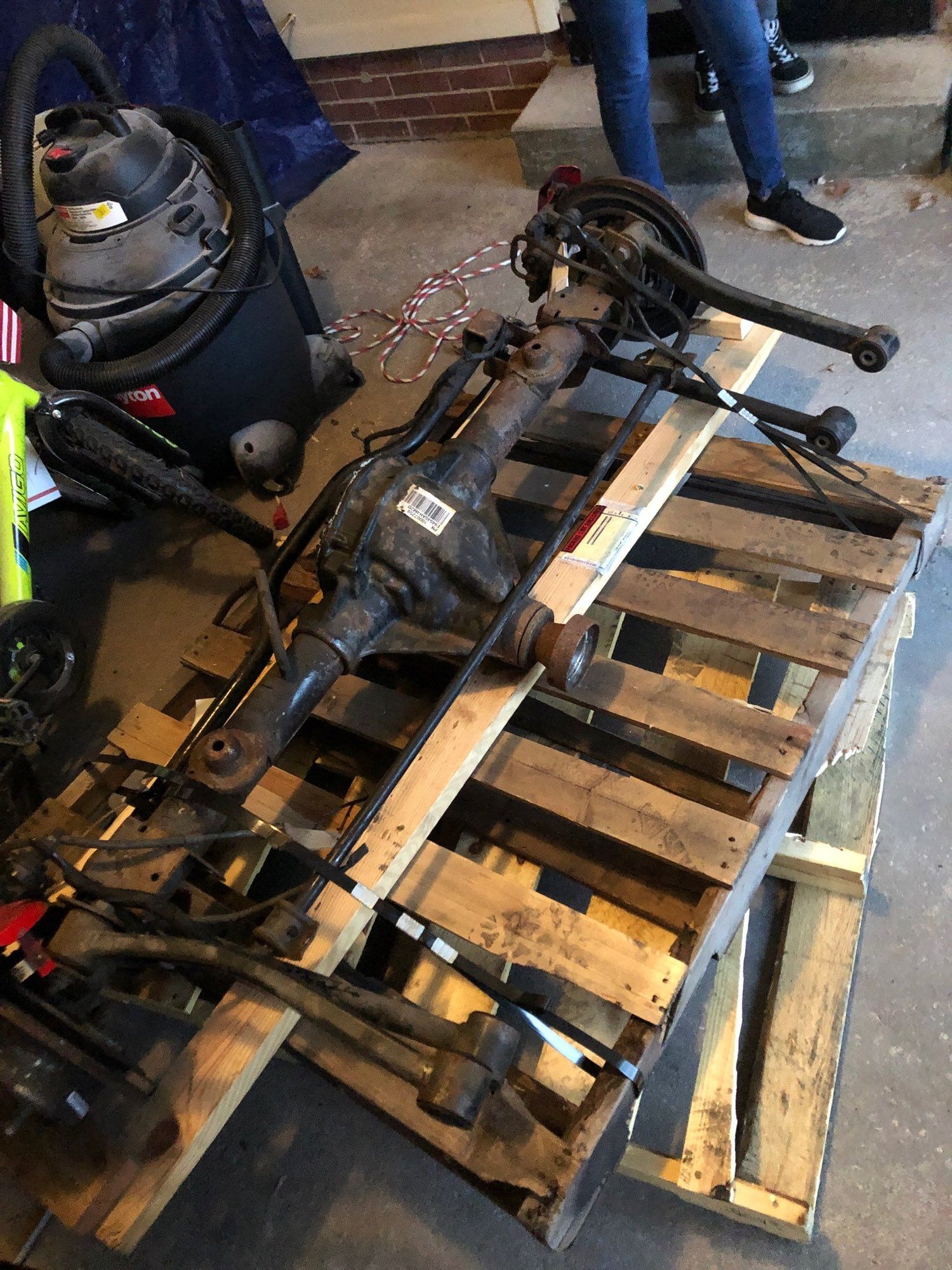

Replacement.

This is a straight forward task. Removing the driveshaft from the pinion flange will probalby be the most fun part. other than that, disconnect your ABS lines, breather tube, unbolt everything and slide it out of the way. Since the pumpkin is in the center on the rear, if's farly easy to balance it on a floor jack to move it. Slide the new one in. Making that first connection is usually the trickiest part. Once you get 2 connections made it goes pretty smoothly. Having 2 floor jacks helps sometimes. Put all bolts in loosely, then torgue em down when the jeep is under it's own weight. Since you have arms on that new axle, I would suggest removing the upper arm and keeping your current one. The bolt at the frame-side on the upper is a bitch cuz you have to hold a flag nut up in the frame rail that the bolt screws in to.

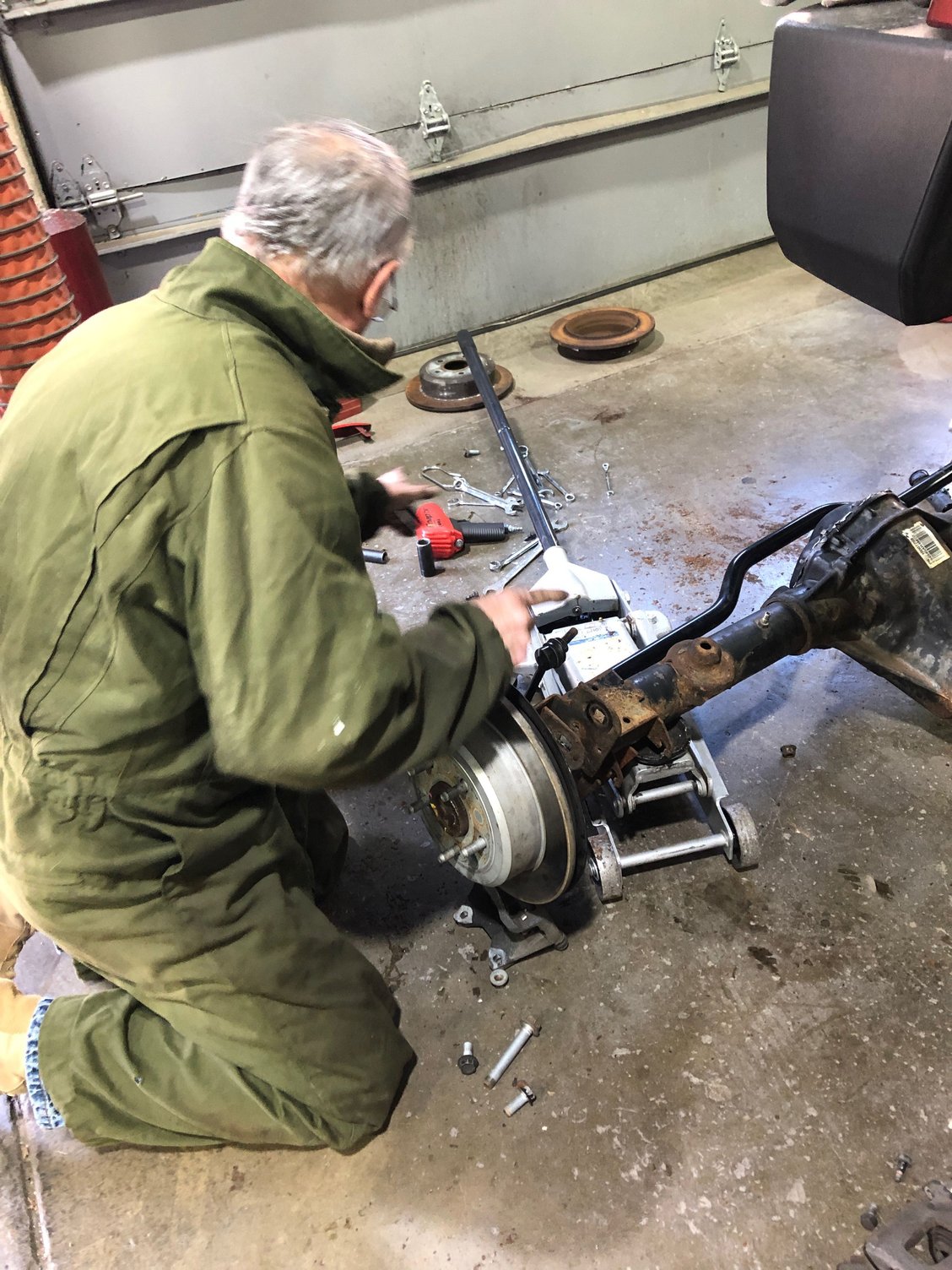

Fellas, thank you so much for all your comments and advises, I was able to take it out and install the new one. New spring coils and new shocks. Took out the cover and clean it up, put new seal, and tomorrow the only thing that I have to do is put the new gear oil and bleed the brakes. It was a learning experience. I will post pictures of the new axle, also as a the cherry on top, came with a monster track bar, so I’m very happy.

Taking the rotors and the calipers out to install them in the newish axle
