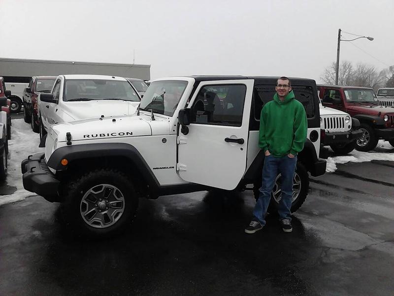

Hello JK forums, I bought a new white rubicon 2 Dr 6 speed on Saturday. Click image for larger version

And after driving it in the last snow storm here in Utah, I LOVE IT. Never had to put it in 4 wheel and my big bad ass bronco would have needed to.
