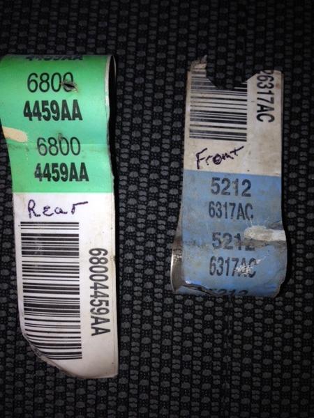

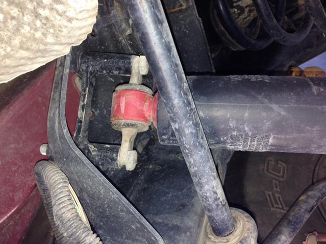

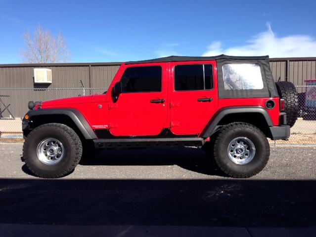

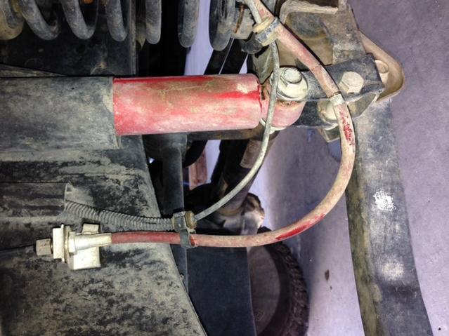

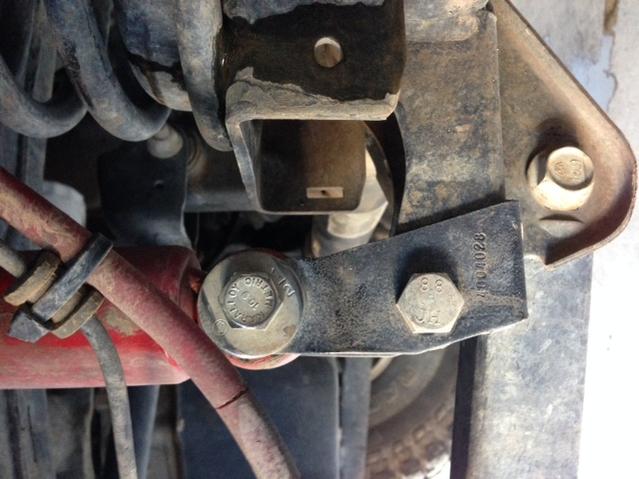

It looks like 2" spacers at top of front and rear springs and 2" shock extensions, on bottom of front shocks, and on top of rear shocks. Possibly new brake lines. Kind of looks like a real budget lift. Not that there is necessarily anything wrong with that, depending on what you all might recommend. I will post the rest of the pictures, only 5 of the 8 downloaded. I want some opinions on the wheel and tire combination. The tires are 35 12.50 15 and the wheels I guess are MB Racing.

The shocks look like Rubicon shocks and the brake lines look aftermarket, most likely extended length. The springs are 17/59s which isn't bad. The front tallest, stiffest factory springs are 19 and the rear tallest, stiffest springs are 60. My Jeep (2 door) came with 14/56s for reference.

Thanks Mr. T! I have taken it over three trails just before the snow set in. One super easy, and two that were moderate. I have no complaints as far as performance there so far. HOWEVER, Clark, I do feel like it is a bit of a gutless wonder (3.73). I figured it was just because I was use to my Duramax Diesel w/egr & dpf deletes and an H&S tuner. Thanks for advice and I was actually thinking about a super charger until I priced them!!! The tuner is probably the way to go. Should I leave those spacers in on the coils and shocks or is it better to replace them with longer coils and longer shocks? Are those Rubicon shocks good? I am ok with the height of the lift, and the look of the Jeep. I am more about function than fashion. And stick around fella's, next I want some opinions on lockers.
