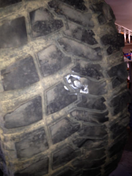

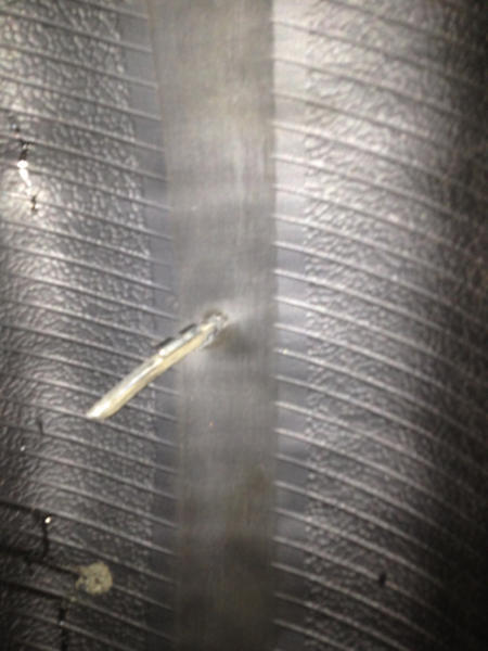

Oh but wait!
At around murphys I heard a pop. I got out and heard a hiss.
A friend said to once, "Brock, if it wasnt for bad luck, youd have no luck."
It was 5:30. Nobody was open. Im 45 minutes from home with almost nothing in between. Theres a new shop in Avery I drove past. I saw a guy closing the shop door and I pulled over. He was closed and just cracked open a beer. Born and raised local he knew the urgency. Heres what we found...

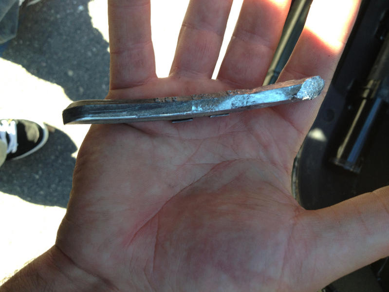

Ya thats a weight. Big 0 put the wrong kind of weight on. Came off the front and went through the rear. I think Big 0 owes me a tire.
He patched up my tire and refused money. I had to force $30 into his hand. Daves Pit Stop. Its a one man show. He wheels jeeps. Honest and friendly. After dealing with incompetent assholes this fuy really shines.
Old Jun 11, 2012 | 06:56 PM
  #50
ChopN's Avatar
Joined: Mar 2010
Posts: 1,455
From: South Lake Tahoe
The weight
