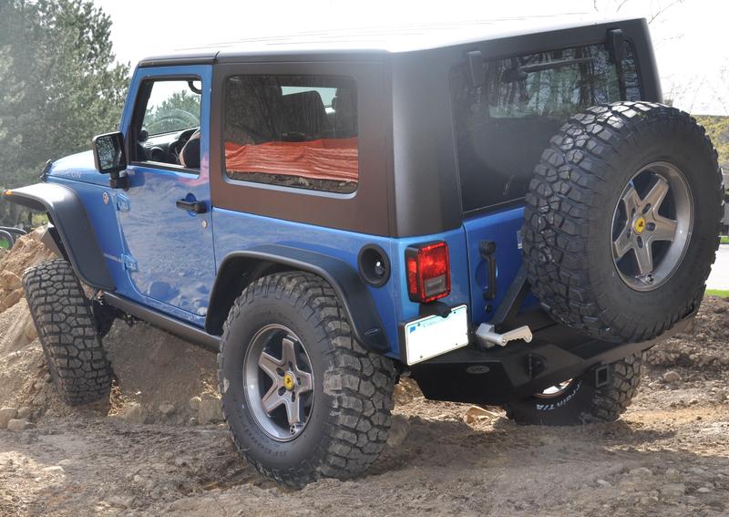

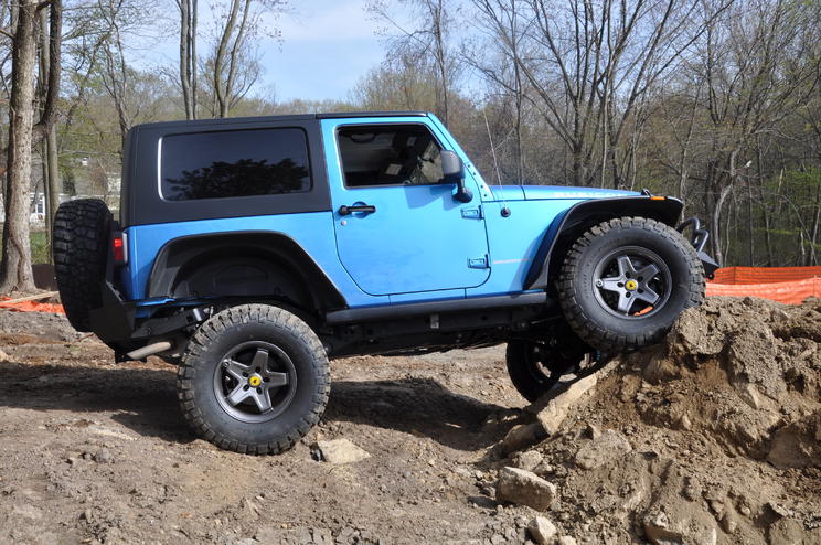

Originally Posted by G3N3RAL
thanks for the info I am already running 35" KM2 and cut my fenfers I will look into RockKrawler thank you.
In fact some old pics of my blue Jeep RK 2.5" max travel kit I wanted to go max flex with ALL 4 coners touching ground for this test:
Juuust about fully tweaked.... Keep in mind that the rear suspension moves in a slight arc. So as it compresses it technically moves aft slightly as the control arms are a constant. I run TF 2.5 bumpstops and have a zero rub along with turning @ flex with the steering stops backed off 1/8" each side.
