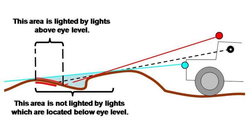

...and... yes and no... :
While a super bright large LED on a lightbar is, IMO, a counter productive overkill (for "bithces" too... ), the location of lights on a lightbar is ideal for offroad lighting -- because they are above eye level:

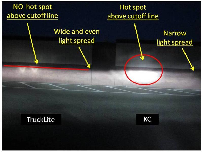

As for the Peterson -- are you sure that its more light and not hot spot(s) ?
I haven't seen a Peterson vs TL comparison, but the Peterson reflector looks very similar to some others, which have hotspots and less even spread than the TL.
Some hotspots can be misleading.
Even spread is better, as we don't know where what we want to see is going to be.
e.g.:

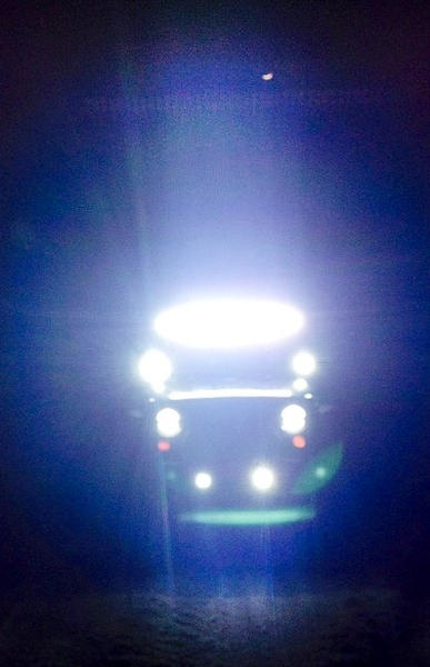

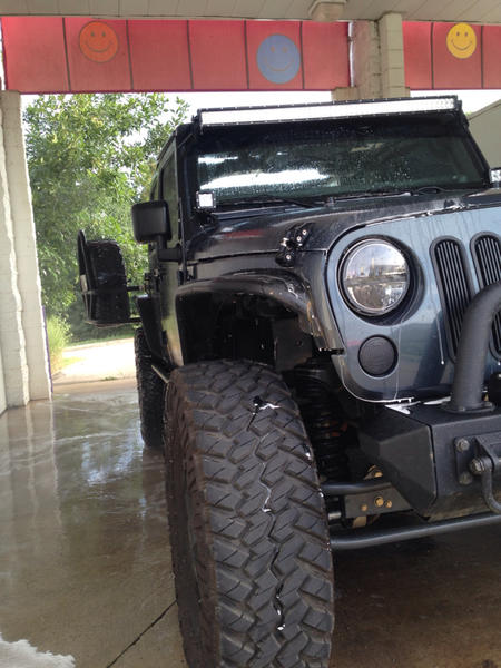

Get'em!

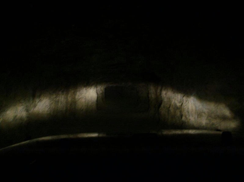

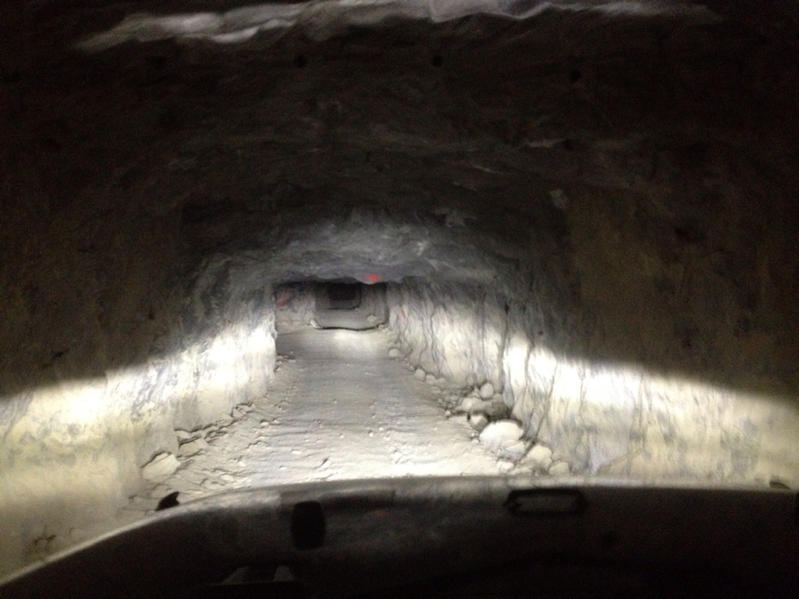

Best mid on my jeep to date is the trucklite's
Here's some comparison shots I took inside reward mine ( pitch black ) a year apart in the exact same spot
Factory headlights and fogs vs trucklite headlights

All lights have their places and uses, as tools.
Only the person who will use the lights can decide what's better for them.
I drove in some forest roads at night where the lightbar was worth its weight in gold. Just look at the photos.
Like already mentioned, no questions about what is in the dark above the normal headlights' cutoff line.

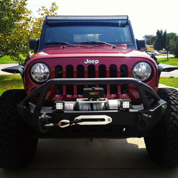

TruckLites ALL DAY!
TruckLites do shed much more light than stock, but the difference between these two pictures is too much, probably because contrast, especially in the stock pic', was exaggerated by the camera.
e.g.:
Attachment 571034
I'm no light expert so whether it had hotspots or not I couldn't really tell you. What I do know... while sitting in the driver or passenger seat looking out the windshield while driving down the road, I felt the Petersons had a brighter, more even spread across the road and I felt I could see farther down the road as well. So if the Petersons have a hotspot and it's bad to the "professionals" then I disagree with them and the hotspot is in the perfect place.
