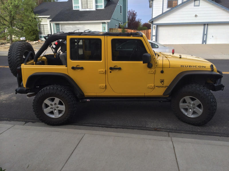

Old Apr 22, 2014 | 04:37 PM
FlyboyX's Avatar
Posts: 97
From: Reno, NV
I've got the 2.5 with geo correction brackets and toyo open country mt 35s. I love the set up. I did have to trim the pinch seams, and I threw the bushwacker flat fenders in there, and that really opened it all up.

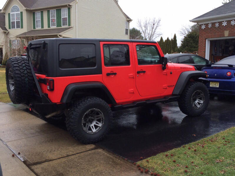

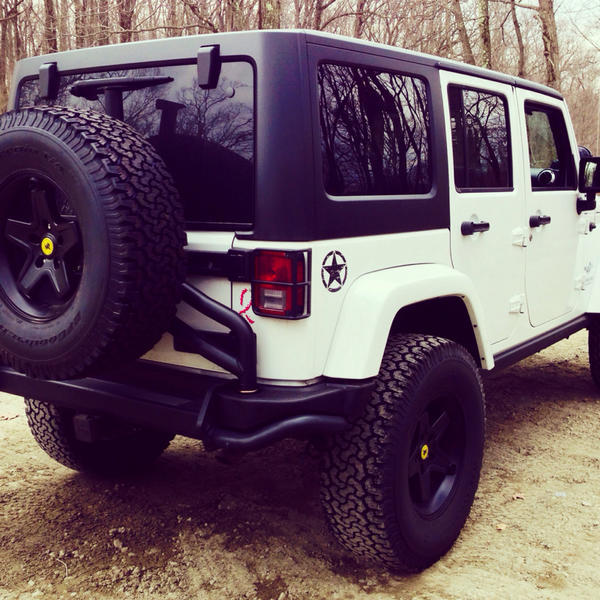

Old Apr 22, 2014 | 06:39 PM
Ndatt10's Avatar
Joined: Jul 2013
Posts: 72
From: North Jersey
I have the 2.5 with 315-70-17 bfg all terrains.

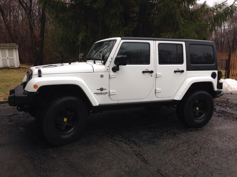

Picture for reference.
I have the AEV 2.5" lift and 285/75x18 Toyo AT2 extremes, they are 34.8"

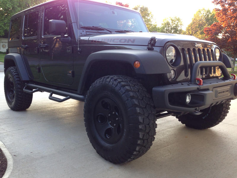

Old May 26, 2014 | 11:55 AM
M3This's Avatar
Joined: Nov 2009
Posts: 42
From: Henderson, NV
Hi I have a AEV 2.5" with Geometry correction brackets and teraflex monster trac bar (couldnt stand how the wheels sat to one side) with 35" Falken Wildpeaks. Love the lift if I can just get my wheels balanced (have two bad tries that are getting replaced this week).

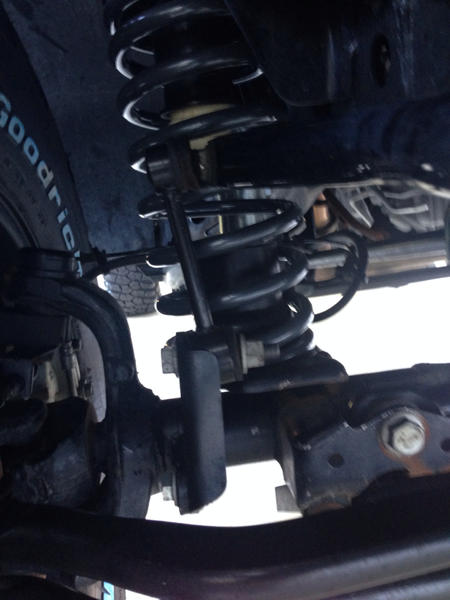

Old May 26, 2014 | 12:52 PM
BCT's Avatar
BCT
Joined: Feb 2014
Posts: 80
From: Northern, Ohio
I have an AEV 2.5 with ego brackets and tire carrier. BFG KM2 35s on AEV Savegre wheels. Love it so far. Gonna lose the sway bar link brackets and install OEM rears in front. Brackets make my sway bar links slanted.
ID:	555680   Click image for larger version
ID:	555681   Click image for larger version
ID:	555682   Click image for larger version
