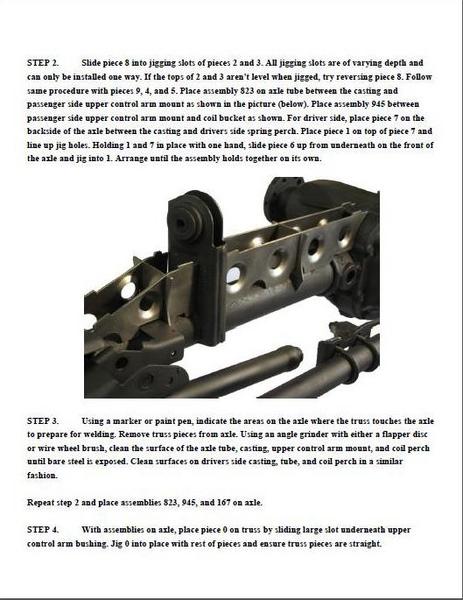

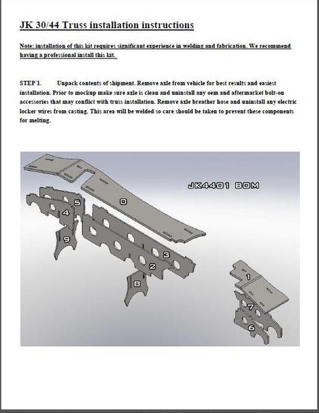

Awesome! Any advice on the truss work? Did you do the 4000deg heat prior?

Only 10 steps for the truss section

Old Dec 25, 2012 | 08:25 PM
Sgt Mack's Avatar
Posts: 1,234
From: O-SIDE
Thanks. I had that in box. Read that they recommend heating up the pumpkin to 4000 before welding.
Sgt Mack's Avatar
Posts: 1,234
From: O-SIDE
4000! That would be awesome.
*400
4000 wth man! Lol you Doing that this weekend?? I just installed fox resies going to pick up new lift kit Friday... Might be welding this weekend!
