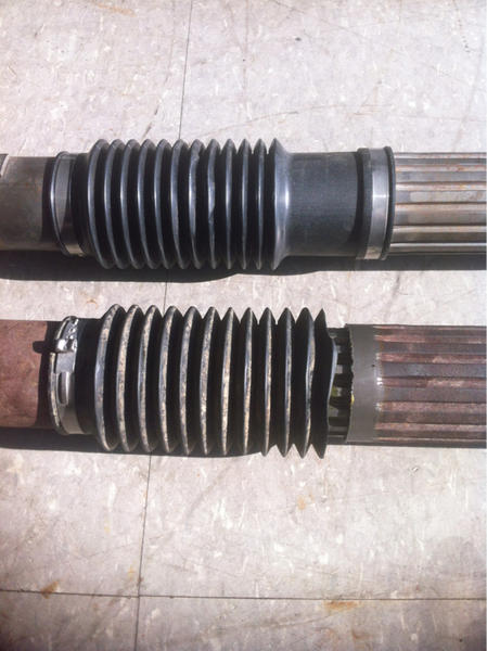

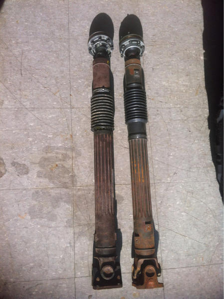

I think it is important to point out that the OEM driveshaft has two potential break points that allow you some time before you have to replace it. The flexible boot on the middle part of the shaft can be removed if it is hitting something and you can probably get away with running it like that for several months to years from what I have seen here with regular inspection and spot greasing. The boot that is near the transfer case or the CV boot is the one that runs a little more risk the longer you let it go and can seize up if the bearings dry out and damage your transfer case which will cost a lot more than a replacement drive shaft. I ran with a torn CV boot for almost 4 months with regular inspection and greasing before I found another drive shaft but I never noticed any clicking so maybe I just got lucky. I would suggest you find an OEM replacement if you are on a budget and changing it takes less than an hour and is straight forward.
This is what mine looked like when I replaced it..
