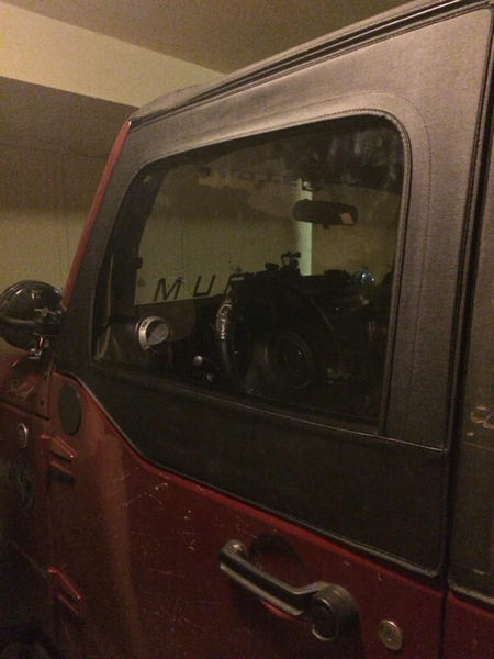

Not a big deal.. But I repaired my upper half door by swapping in a replacement skin for 30 bucks vice a factory replacement @ 430+. Just took a few hours, and a lot of heat to get the darn thing on lol. Now what to use that 400 bucks on... Hmmm...
Attachment 522687
tell me more about this replacement skin

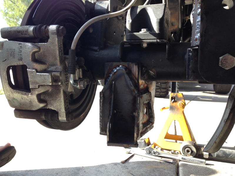

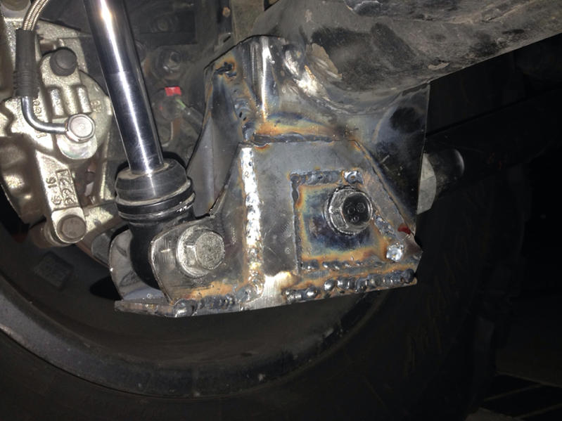

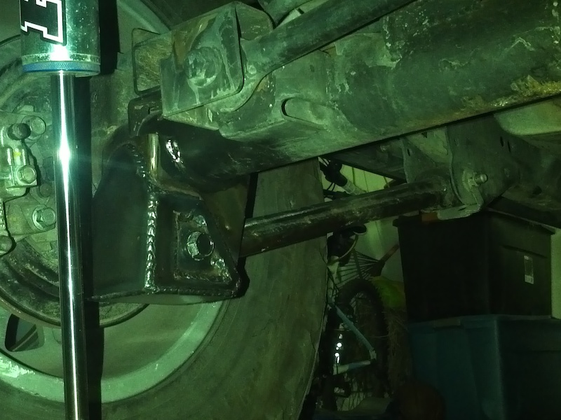

Problem: Shock was hitting trackbar relocation mount.
Solution: BRUT4CE Offroad
Yesterday he chopped lower shock mount, relocated and welded new mount with control arm skid. More clearance & down travel, no more shock mangling the trackbar bracket
Thanks again Travis

That looks great!!!

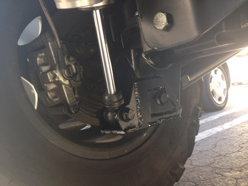

Thanks buddy. Travis does great work. Here's one more pic after paint dry

Had fox shox rebuild my shocks today, did a windshield decal....kind of a boring day worked on other peoples stuff (fenders, slkders, skins for tube doors, ) and some contract work for some interesting people....
Thanks mike....its amazing how things look better in person...lol

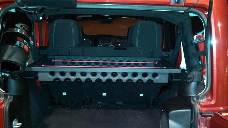

installed my new ACE rack
