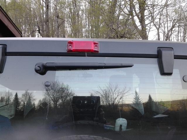

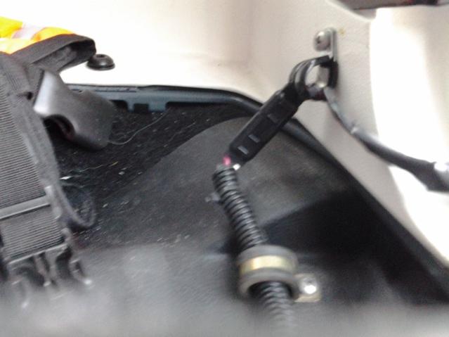

Default Relocated 3rd Eye (CHMSL)

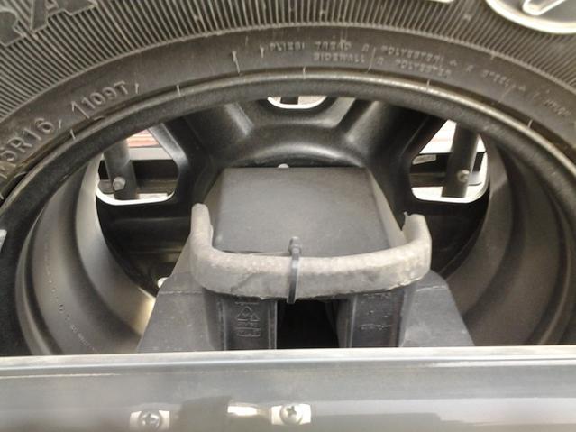

I relocated the vision-blocking CHMSL to a surface mount LED on the hard top.
Remove spare tire, disconnect harness, mark and cut off oem "stalk". I used modular plug to disconnect when removing hardtop. Also capped and left oem harness plug for plug/play LED when topless. The new harness runs parallel to oem inside tailgate, through loom, using factory hot and ground, same gauge wire.Tucked into space next to glass gasket, held with body sealant .Click image for larger version

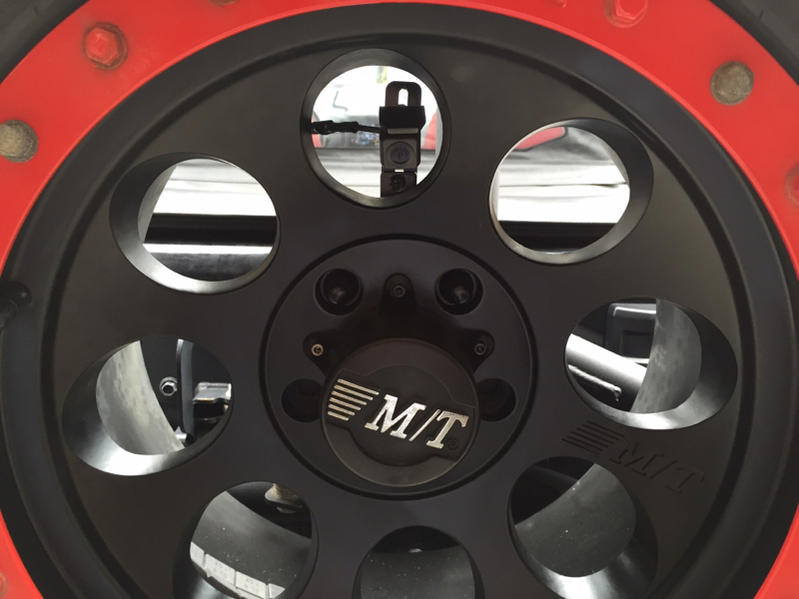

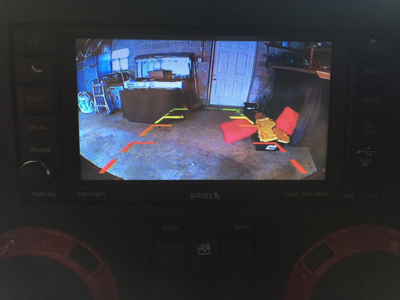

Installed Brandmotion Backup Camera. Now i can stop hitting those small car annoyances behind me when i park in the city

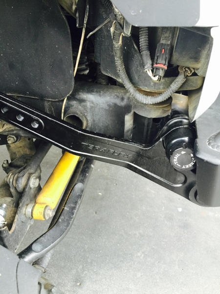

New Teraflex sway bar disconnects! Thank you MIT and Teraflex!

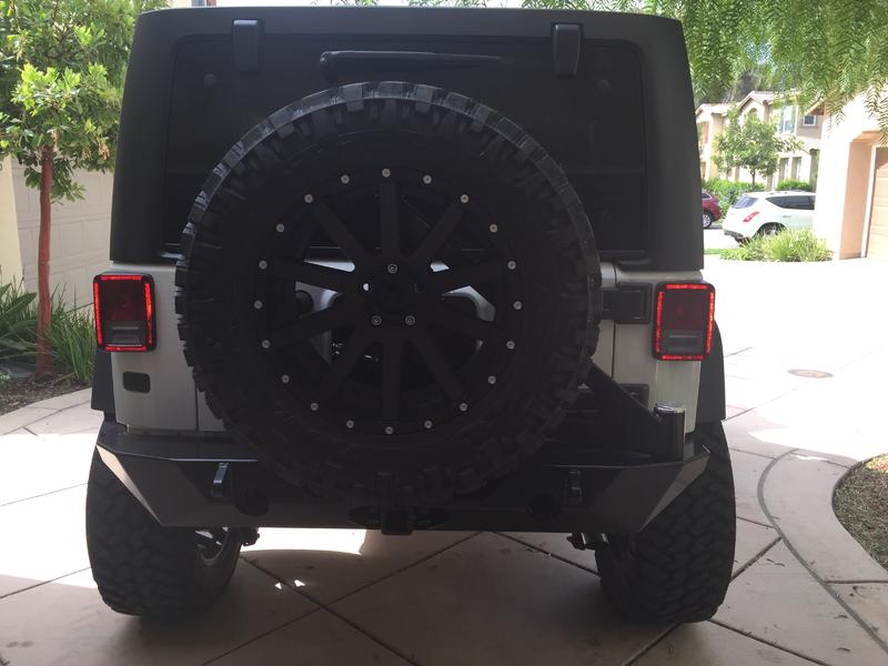

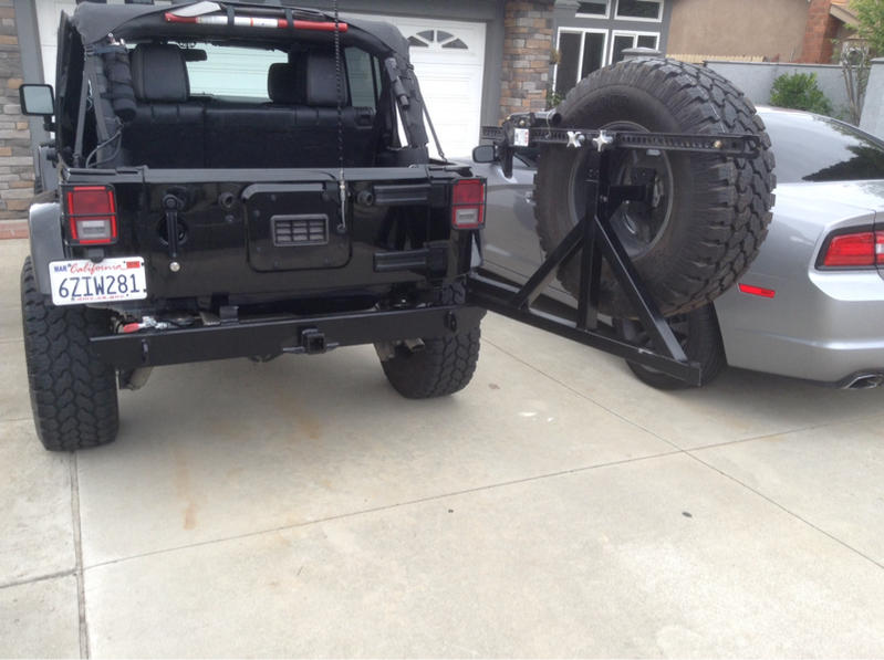

Installed new Dirtworx rear bumper/carrier, ran coaxe for CB and new Firestick. Ready for Calico in the morning.

Are those quick disconnect...something that do the same as the JKS quick disconnect? I have some from Teraflex but they don't look like that...

That's the dual/rate swaybar system. What you have are quick disconnect LINKS, which this system doesn't require actually disconnecting.

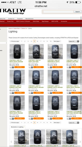

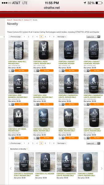

Sorry havent been on for a minute.. The website is www.otrattw.net Lot of exclusive designs, even funky ones lol

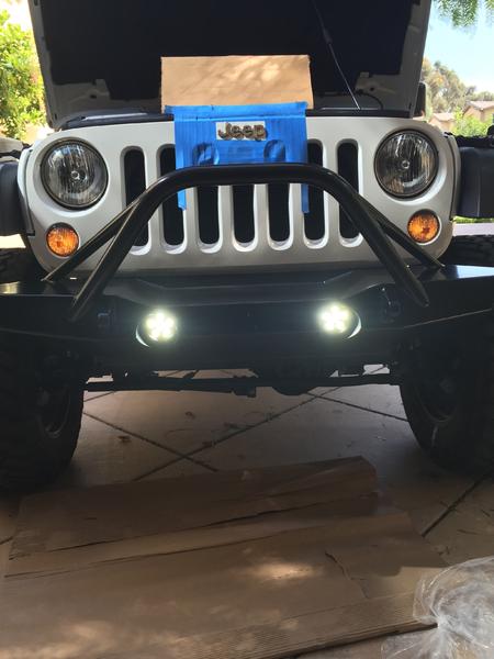

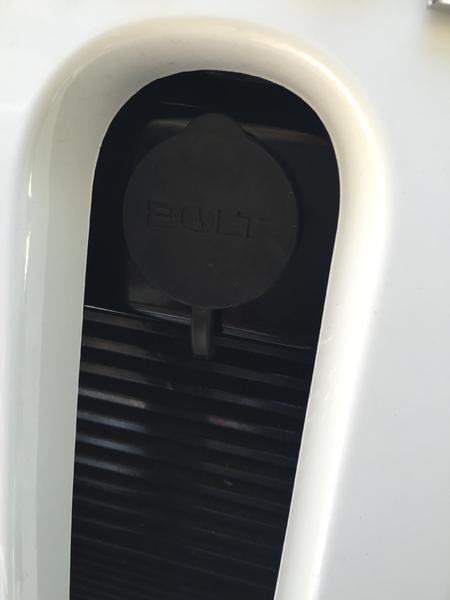

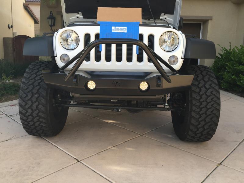

Got my Poison Spyder bumpers back from PC and installed, fog lights in, BOLT hood lock installed and Plasti-dipped the JEEP emblem.

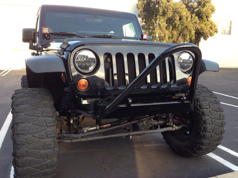

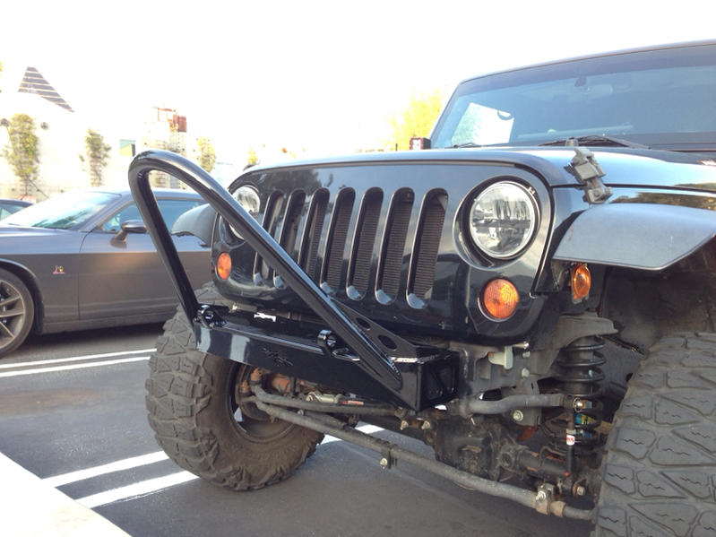

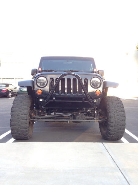

Powder coated my PSC BFH trail stinger gloss black.
