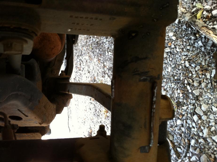

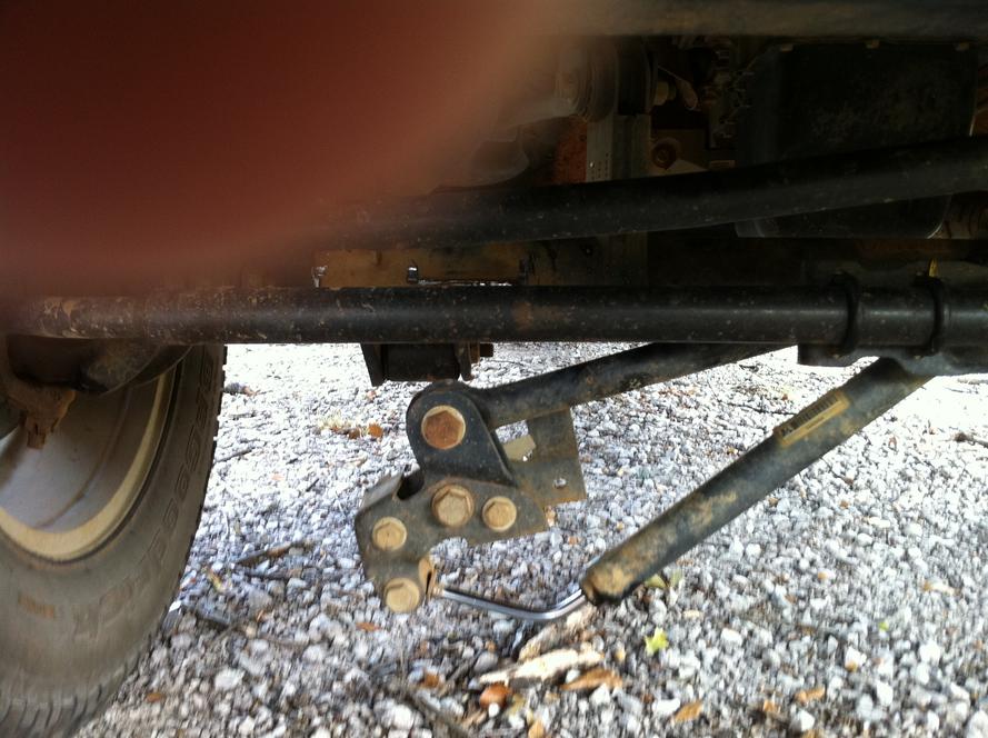

Remove this bracket if you have one. I was lucky that I was only go about 25 when it broke. It was the worst Death Wooble I had ever felt.
Skyjacker Front Track Bar Bracket for 07-10 Jeep® Wrangler & Wrangler Unlimited JK with 2.5"-5" Lift
Sorry to hear about the damage, but glad you're okay Monty. Removing/avoiding this hardware is also especially true of the older rear track bar bracket "designed" by this company.

From: Trinity Alabama
I am glad I never put the rear on it will be scrap now. Not even sure what it will cost to have it fixed.
Probably need to do a little welding to re-attach the stock front bracket, then purchase the JKS or Teraflex support bracket as reinforcement for the final solution. Maybe a couple hundred total?
By the way, here's a pic from some poor unfortunate documenting the rear bracket "in action".
