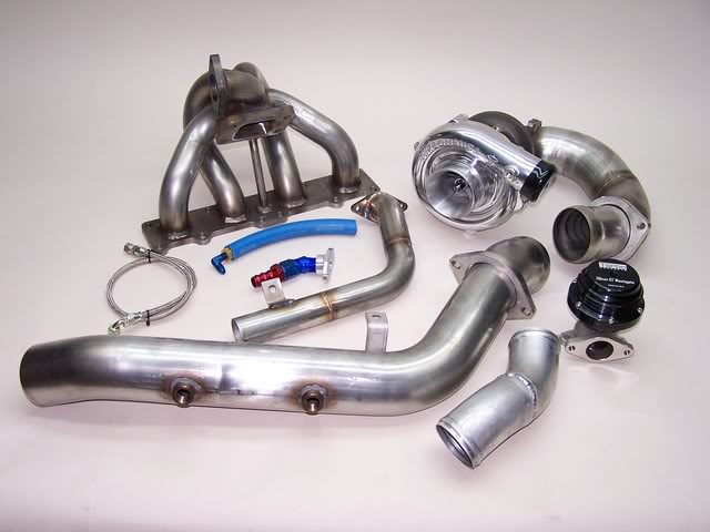

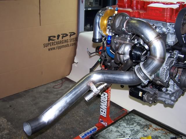

Both are a different means to accomplish the same end. Each has it's own particular strengths and weaknesses. We feel, and 1900 systems justifiably so, That in terms of reliability, ease of installation, and all around power production, we have made the best balanced system. We have manufactured Turbo systems as well, ( RIPP SRT4 50 trim TURBO KIT ) ( RIPP INTEGRA RACE CAR) we just didn't feel it was the right thing for a jeep.
My head hurts now.
Hope that helps.
RIPP
