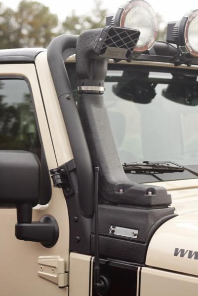

[QUOTE=Rugged_Ridge;2663023]Here are a couple new shots of the snorkel.
I was liking the look of this snorkel until I seen this photo. I don't like how the finish on it looks uneven and globby like someone cast it in the mold and sent it straight to the paint shop instead of a little machining/finishing work to make it look nice. It doesn't take much to throw the part on a belt grinder for a few quick swipes to make it look much more even/refined. That's what I did with the latch that came with my XHD rear bumper/tire carrier, and then repainted it myself. If this snorkel had a nice even textured finish like on the XHD bumpers (not the latch part) I would totally get it though.....I'm just kinda picky that way. I am a knifemaker and it makes me the sort of person who notices finishing details such as this. I like like Rugged Ridge products, but I would be willing to pay more money their stuff if they were finished with a little more attention to detail. Looking from a distance though, it is a great looking, functional design as is most all of their stuff.

I've browsing through the thread looking for how it will look like.
Found this prototype photo:
I have to agree with RR's own assessment that the product's finish still has long ways to go. That area around the silver plate looks like crushed cardboard. And the overall finish looks very irregular.
Sorry for being blunt, but whichever company you guys are contracting to do the molds still has a long way to go in terms of learning how to build them. I used to design plastic and metal parts in the beginning of my career and can tell where some mistakes are being made.
Anyway, still looking forward to seeing how the final product will look like. My vote is to wait more if it means fixing that stuff. ;-)
