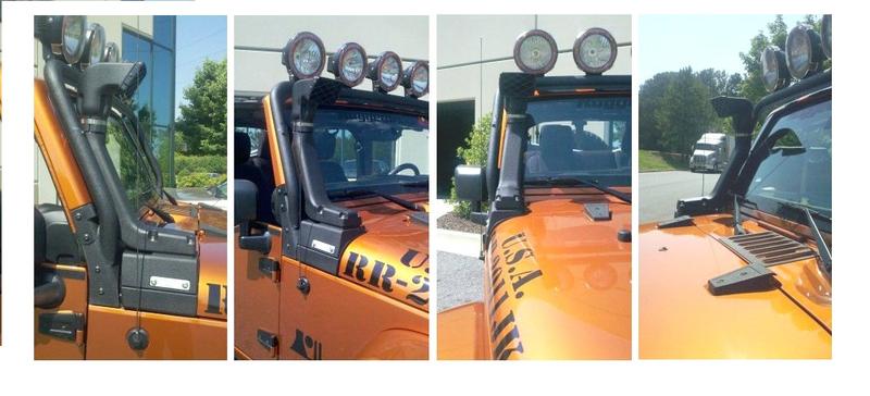

Originally Posted by jpthunder
This is awesome! Is there any way to keep it low on the hood (short mount) underneath windshield lights? Love my windshield lights and don't want to lose them. Thanks.
Yes... As seen in several of the posted images the low mount allows your W/S lights and brackets to still be used.

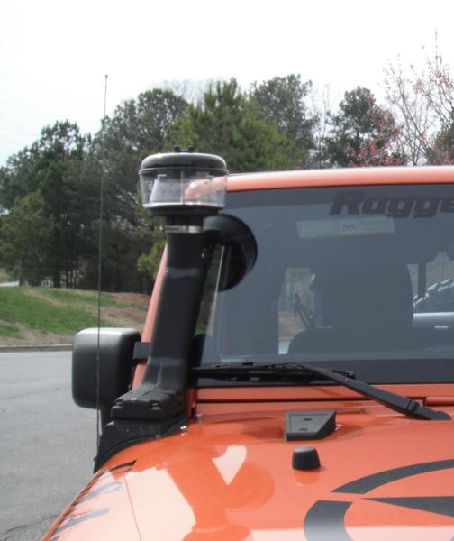

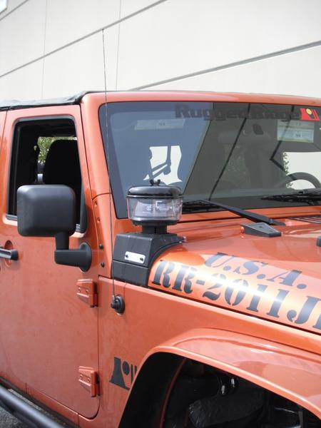

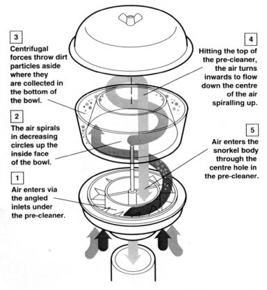

[QUOTE=Rugged_Ridge;2271772]Attachment 157502Attachment 157501Attachment 157503
Originally Posted by Bingbola
The pre-filter low mount will be a secondary part. Meaning we will start development of it after the completion of the main design. The pre-filter will mount to the standard high mount as shown....
PLEASE no comments about the size if the high intake... This has been reworked and has been made more proportional to the rest of the system.
At this time the pre-filter will be a sourced item but we may look into developing our own version if we see a need.
Sorry , but still has the ugly pills taken by most other snorkels. The round filter looks seriously odd. What about a stubby forward pointing filter as an option?

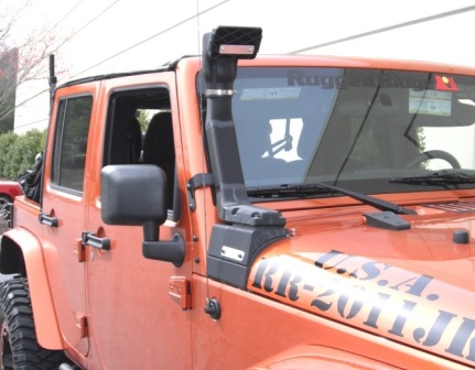

Updated high intake.... Please no request to see it without the light bar. Jeep is being set up for display and I am unable to remove items at this time.
The original design has been put up to show the size increase.
