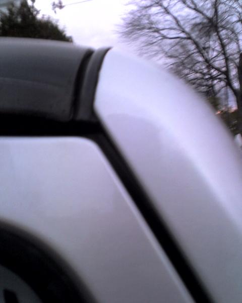

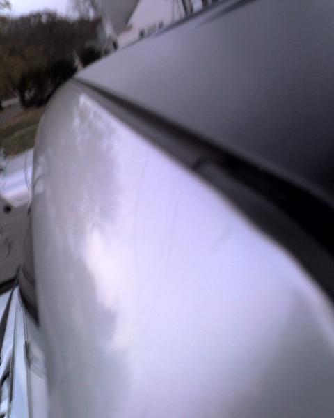

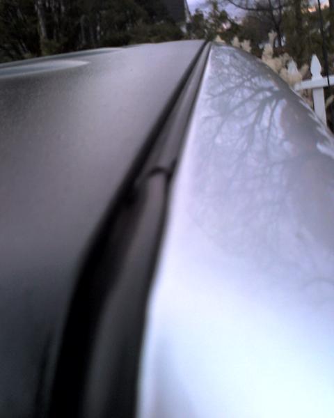

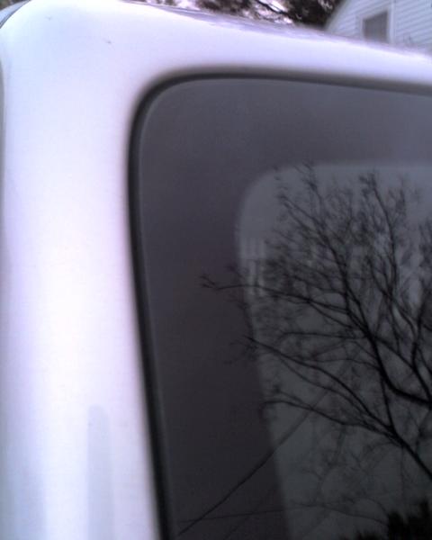

Here's a few pics....Click image for larger version
ID:	101060Click image for larger version
ID:	101063Click image for larger version
ID:	101062Click image for larger version

Reason I asked for the pictures was I owned a 07 sahara, and had ZERO water leaks.. I recently picked up an 08 rubicon, and I put my hardtop from the 07 on the 08, and was getting a nice water leak down the inside of the passenger side footwell.
I kind of guessed how the water was getting in.
I wanted to see if the 2007 weather strip was different then my 2008 weather strip. It's not. :( But I did notice that on my 08 the strip was peeling back from the pressure of the hardtop closing, so I super glued the strip back down tightly against the windshield frame and so far I have not noticed any more leaking !!
Thanks again to those who contributed!
