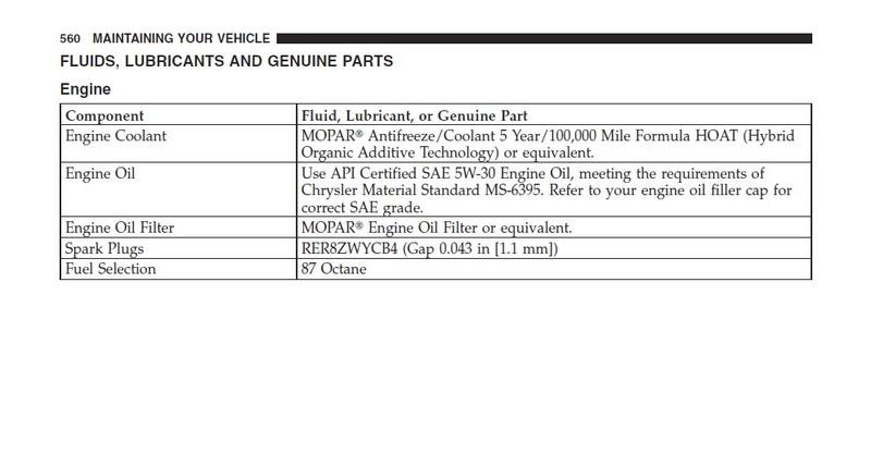

Gort's Avatar
Posts: 285
From: Central PA
Originally Posted by Tonka_yellow
My buddy has a 12 and the book says 5w20 but he called the dealer and they said to run 5w30
That's very, very interesting. I also have a 12 and my manual says 5W30. Is this an early or late 12 build? I'm wondering if Chrysler changed something in mid-stream on the oil weight.
