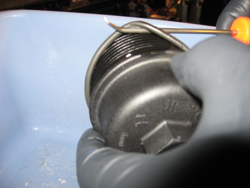

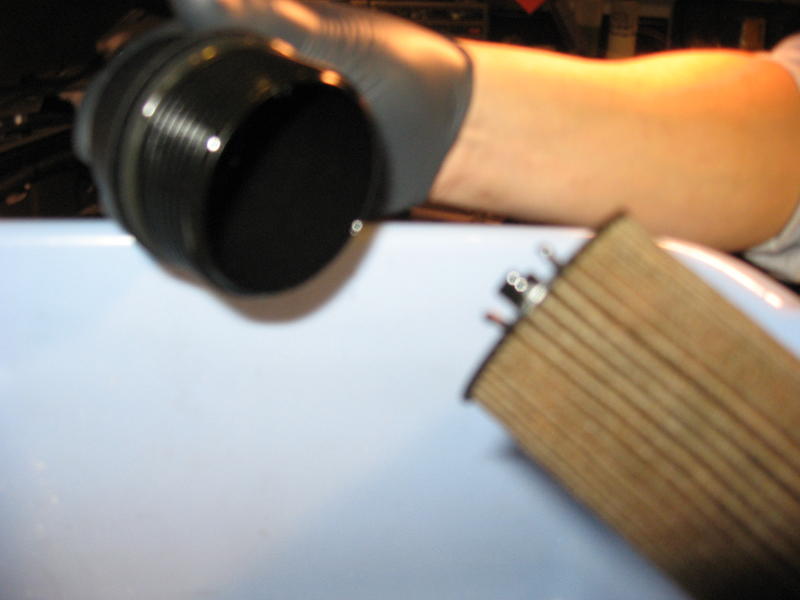

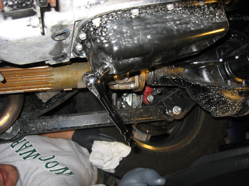

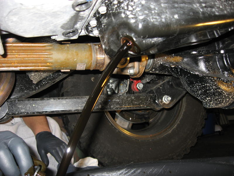

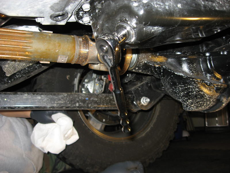

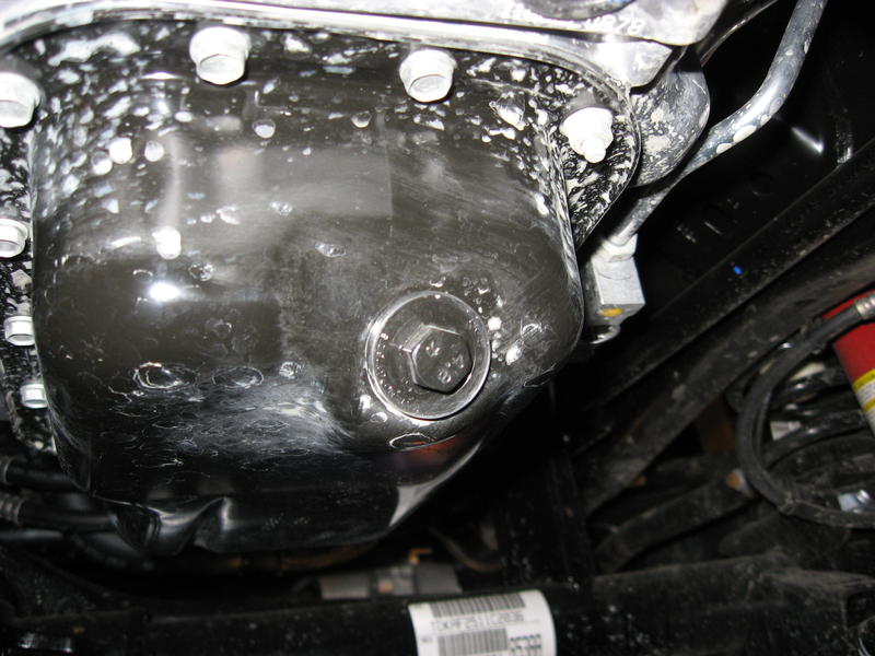

Default Oil change photos first five
ID:	235892Click image for larger version
ID:	235893Click image for larger version
ID:	235894Click image for larger version
ID:	235895Click image for larger version

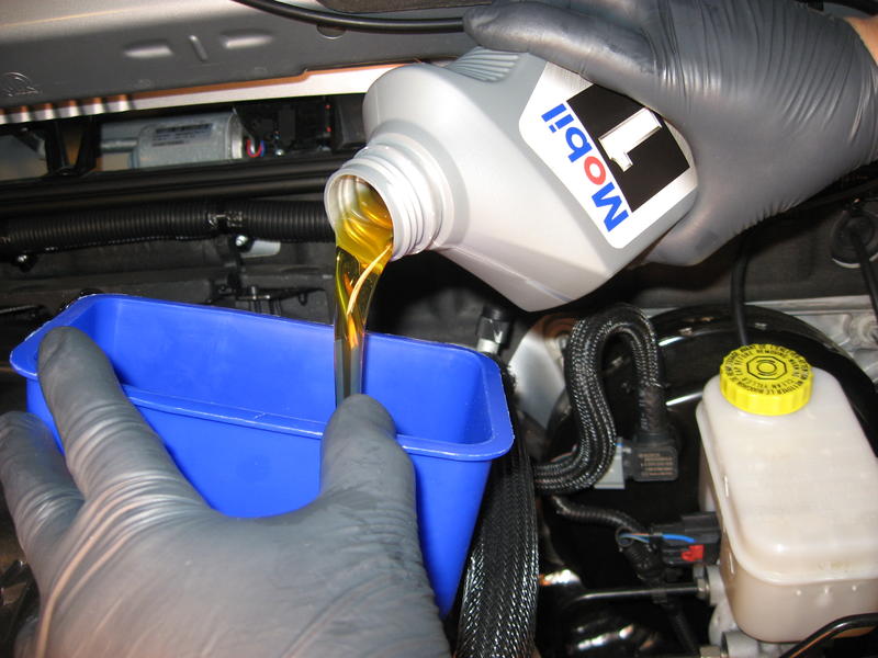

Default Oil change photos 2nd five
ID:	235907Click image for larger version
ID:	235908Click image for larger version
ID:	235909Click image for larger version
ID:	235910Click image for larger version

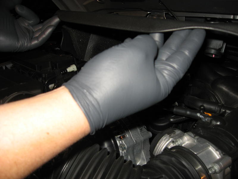

Default Oil change photos #3
ID:	235912Click image for larger version
ID:	235913Click image for larger version
ID:	235914Click image for larger version
ID:	235915Click image for larger version

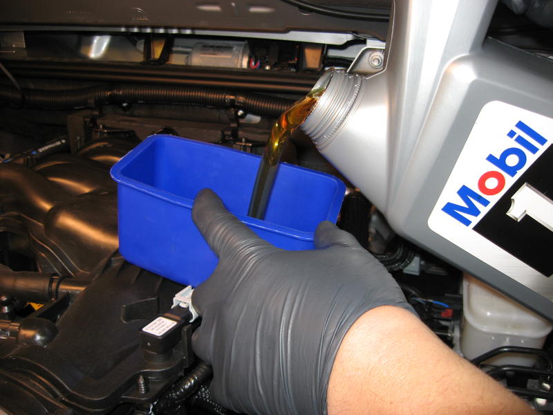

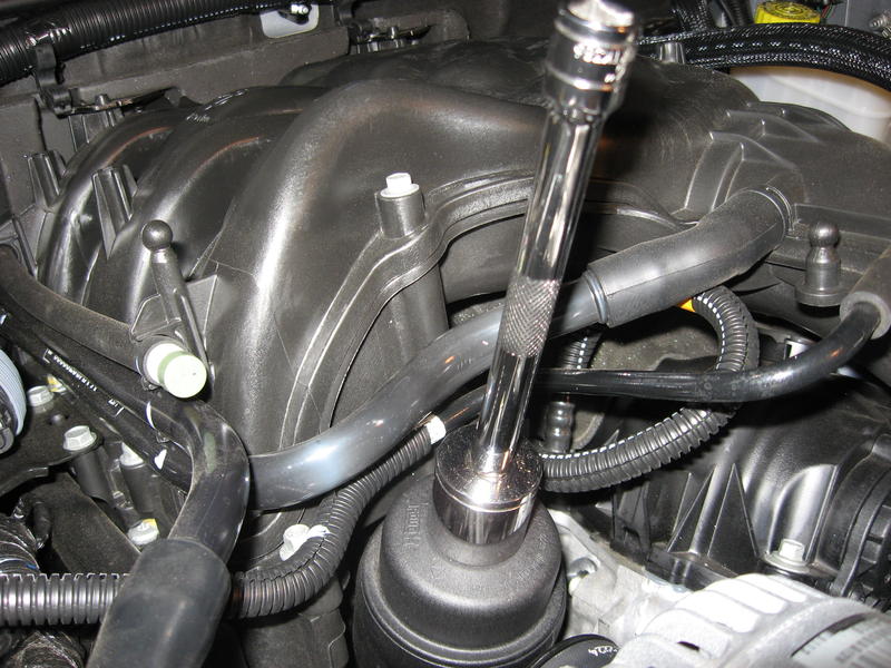

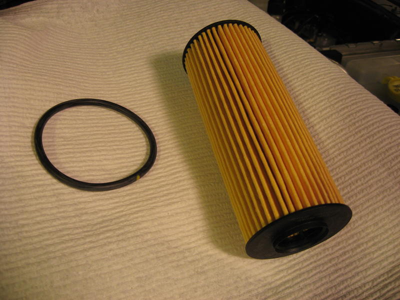

Default Oil change photos last set
ID:	235917Click image for larger version
ID:	235918Click image for larger version
ID:	235919Click image for larger version
ID:	235920Click image for larger version
ID:	235921Oil change took about 10 minuets. Very easy to work on!!

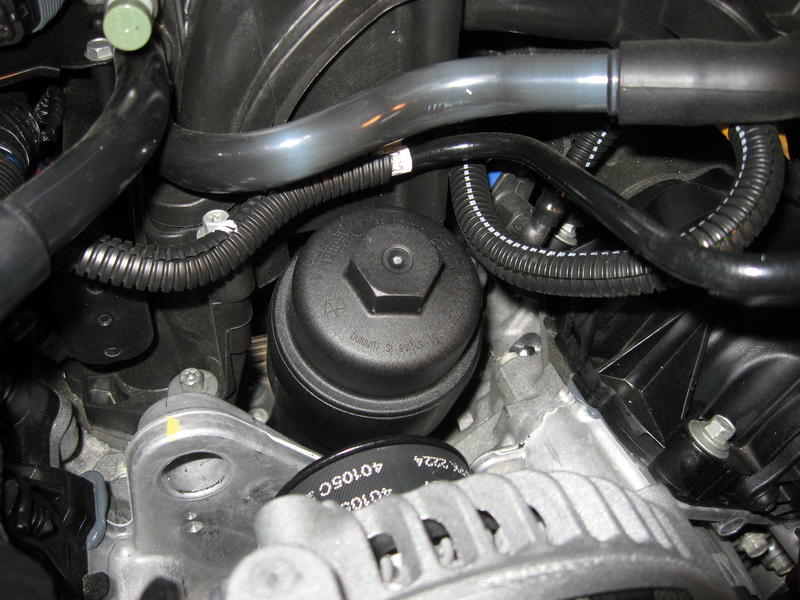

Thanks for the pics. I was wondering whether or not this new engine had a cartridge style oil filter.
You can sure tell this engine was co-developed with Daimler, the oil filter looks just like the one in the Sprinter van. Same o ring setup too
