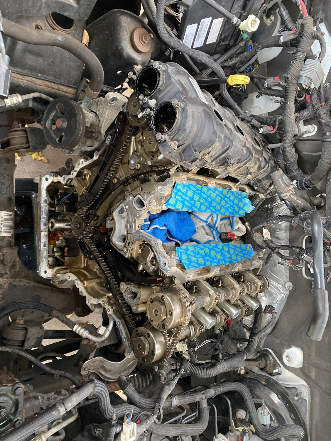

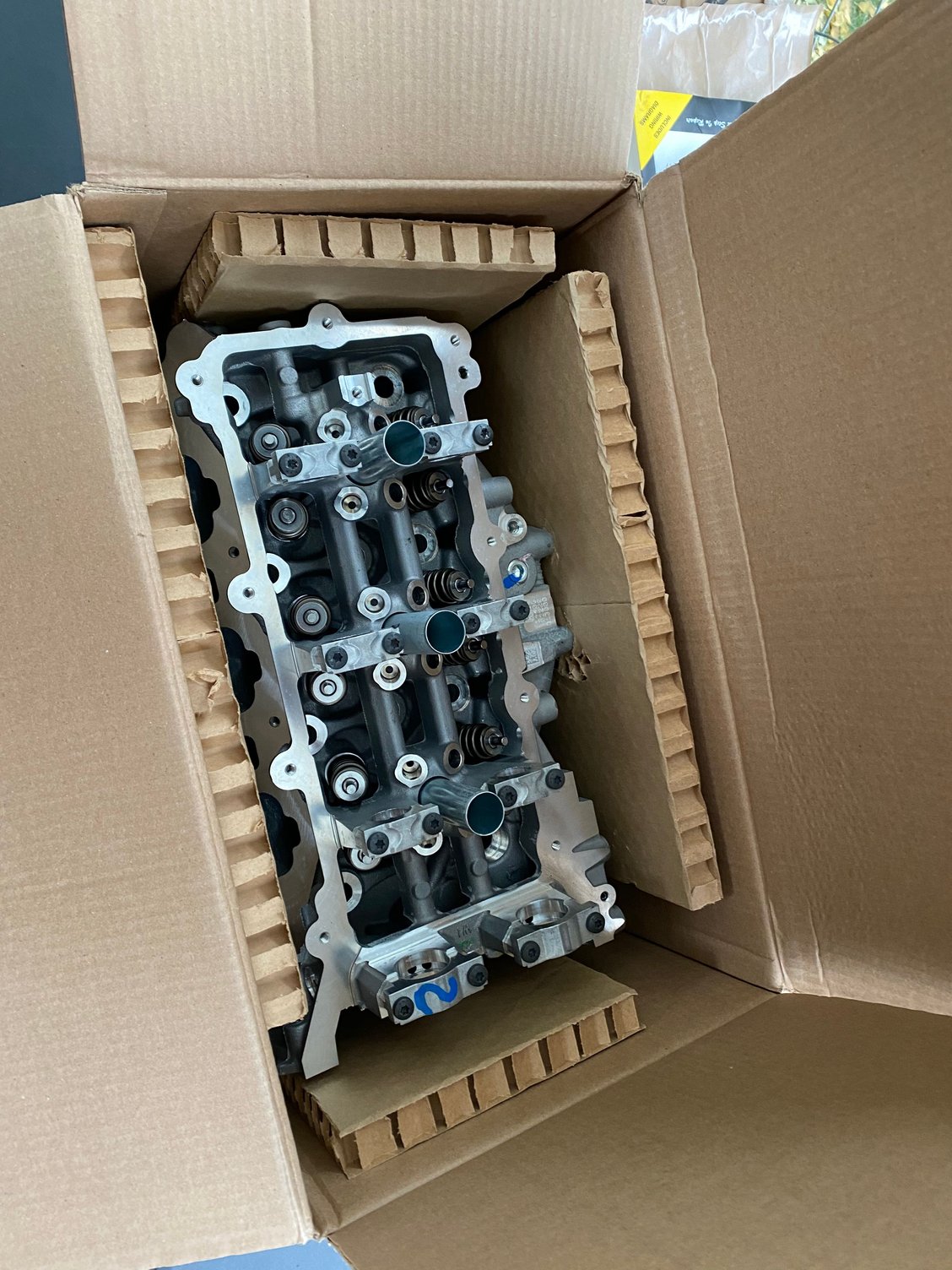

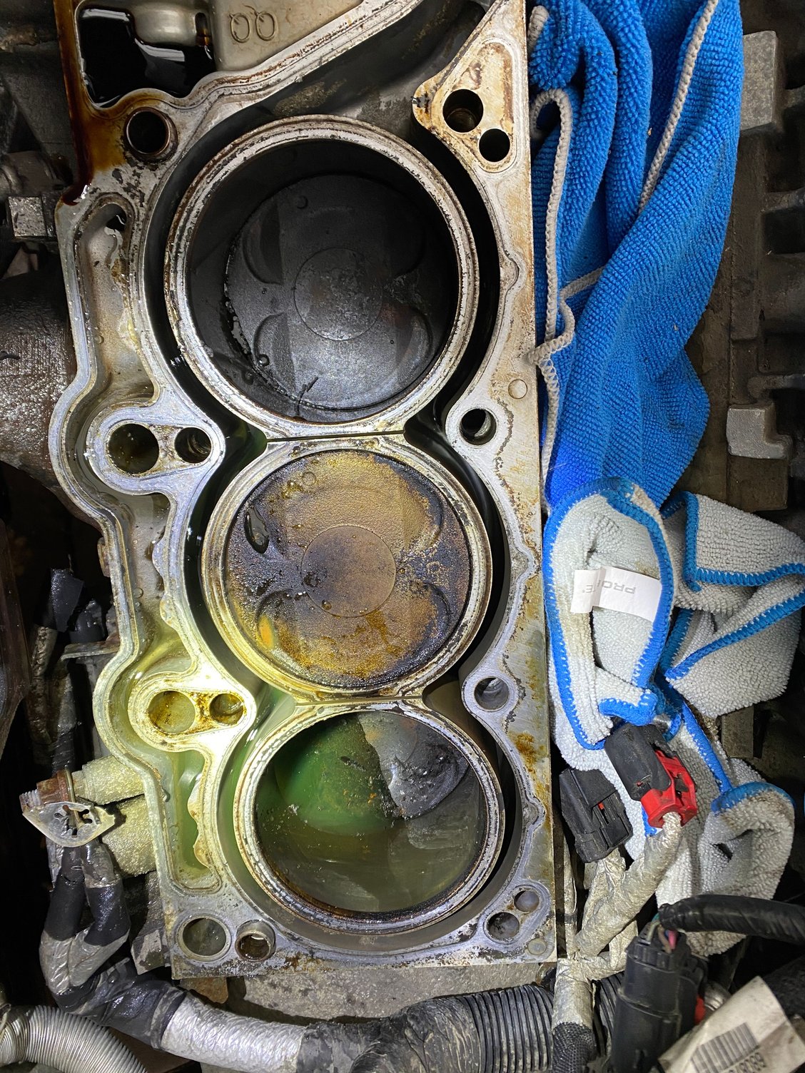

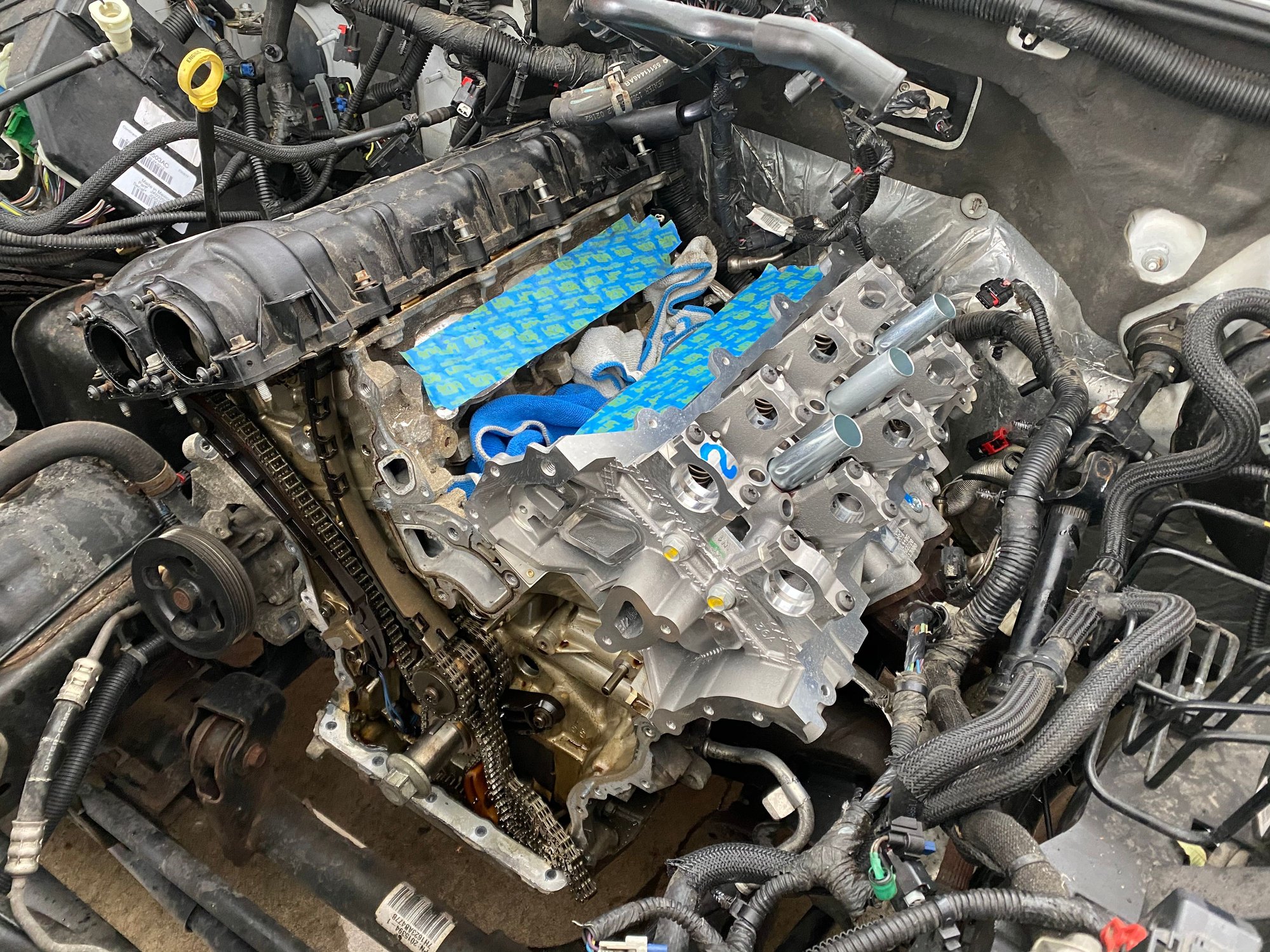

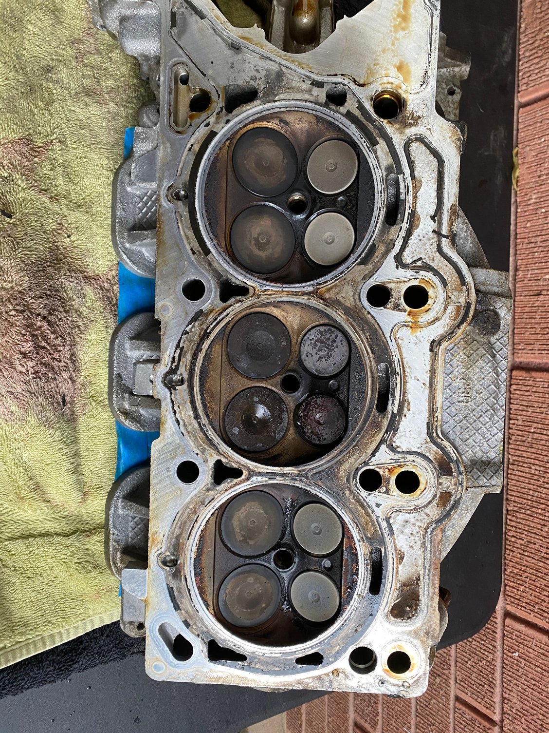

I did, i have been incredibly busy with moving and forgot to post the results on here sorry about that guys. It ended up being the drivers side cylinder head requiring replacement, it was warped. I changed it myself and its been running perfectly for the past couple weeks. Apparently this issue is relatively wide spread on the earlier 3.6, yours being a 3.8 i dont think you would have the same issue.
