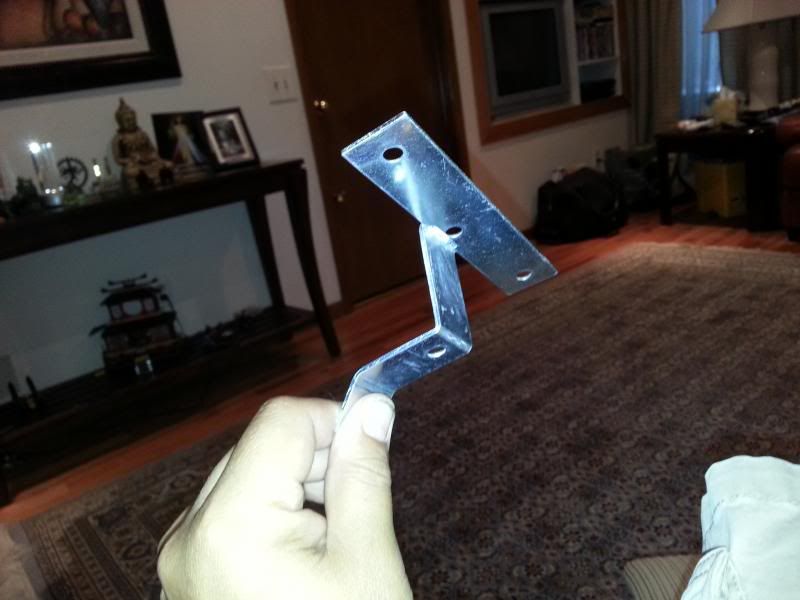

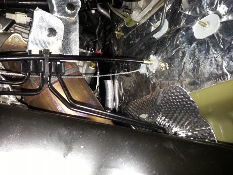

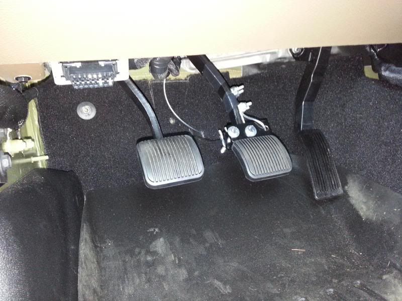

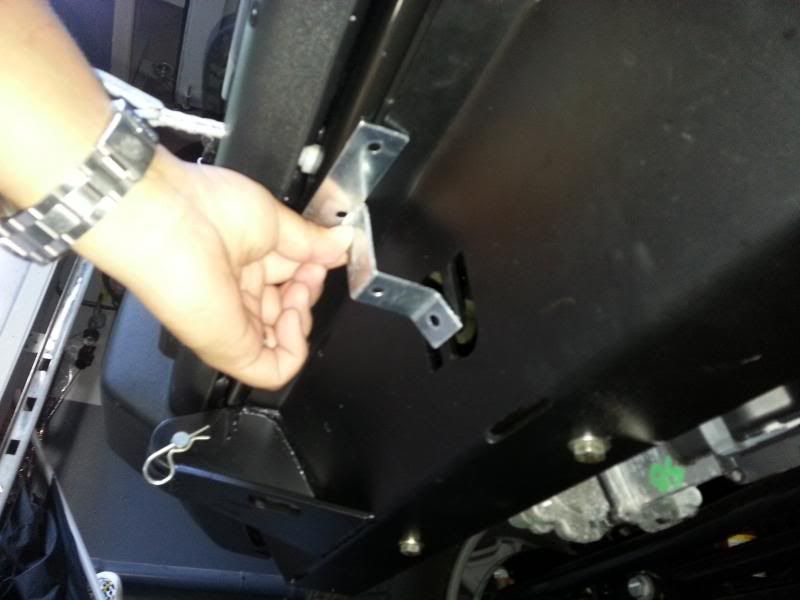

2013 jku, flat tow using a readybrute elite tow bar, mopar wire harness and nvs breakaway cable..
I was gonna go with a bracket that I made from a "T" plate from home depot. After much thought, I opted for through the bumper method.... One less thing to worry about when off roading and the skid plate is clean, no light mounts, no teflon ready brake mounts exposed... It is a skid plate you know.
I went with the mopar cable... and I see the reasoning why Jeep went this route. The harness runs on the top and then down the sides of the front radiator grill. No seven pin plug to mount. Just reach in the grill grab the harness and plug your 7 pin cable. Cool!
Here are some pics...

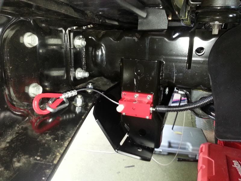

I will prob create a metal bracket to hang the breakaway cable behind this bumper, that bolt should be perfect for the bracket.
closed up...
I love the clean look... you would never know its a toad once that readybrake loop is tucked underneath the licence plate and the breakaway cable stored behind the bumper.
closed up...
