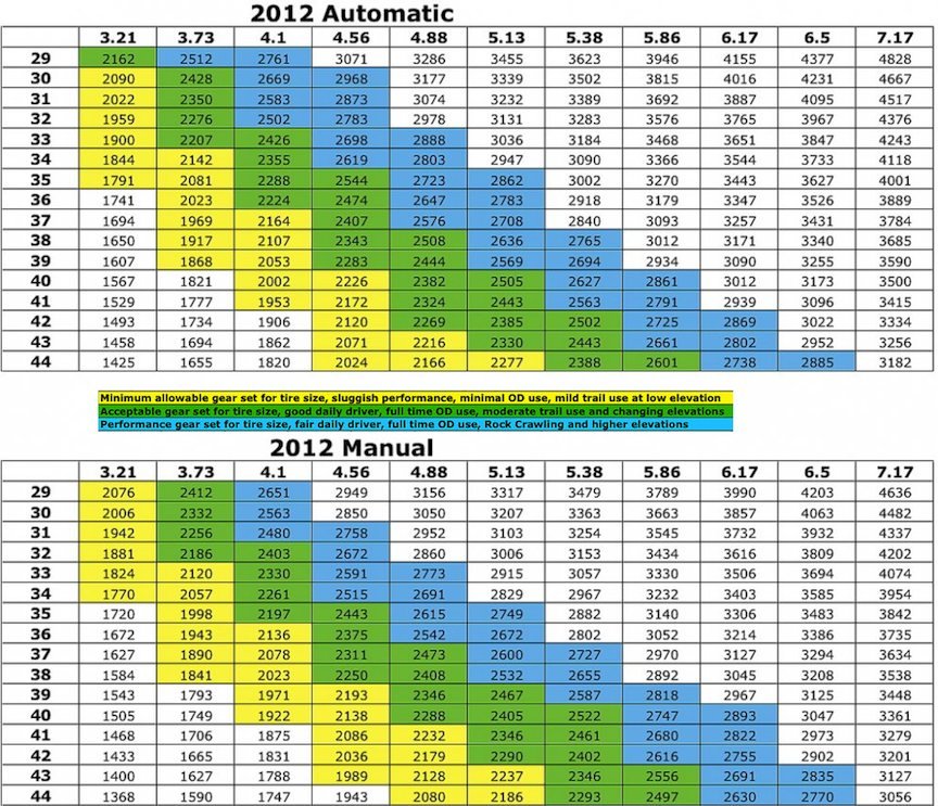

As of now I am completely satisfied with my 33's (32.8's actually) and dont plan on going to 35's, but MAY consider doing so down the road so will 4.10's be a good gear for both tire sizes?
My question is, does anyone out there have 4.10s installed on their manual JKU and drive long distances like I do? Would you recommend another ratio? I'd like to drive at a speed of 80 mph without killing my gas budget so are 4.10s are good gear for my application? I really just want to get the acceleration back as well as some MPG's to make this work, as I do plan on installing a 2.5 lift and know that will also effect my MPG.

As far as gear ratio is concerned, Rubicon's come stock with 4.10's. They have 32" mud terrains and they do fine. That being said, the rpm difference between 4:10 and 4:56 is less than 300. I have known people to run 4:10's on 35's and others who run 4:56's. In my opinion, I would run 4:56 if you plan on going to a 35" tire. Even if that's a year or two from now. It's a big and expensive job so you only want to do it once.
