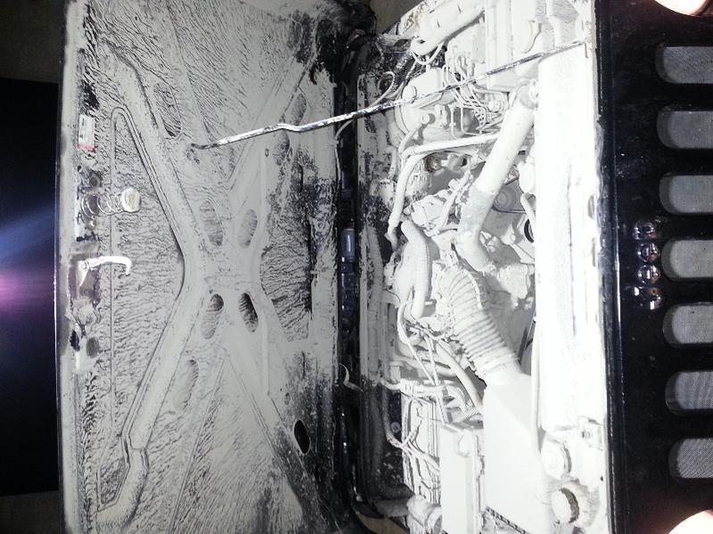

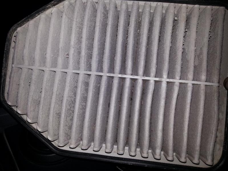

Old Sep 20, 2013 | 05:14 PM
2009rockymountain's Avatar
Joined: Feb 2013
Posts: 176
From: Grey Bruce Ontario Canada
here is a pic of egine bay before I hosed it down with spot free rince
Attachment 499074
Attachment 499075
That information should have been in the first post.
