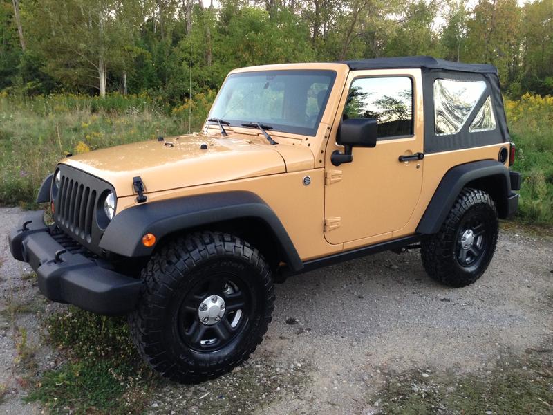

Old Oct 7, 2013 | 06:33 AM
jtphoto JK's Avatar
Joined: Apr 2008
Posts: 1,267
From: Thunder Bay, Ontario
33x12.50x16 on PC wheels 4.5" BS. No lift no problem other then rub a bit on plastic airdam at full lock.

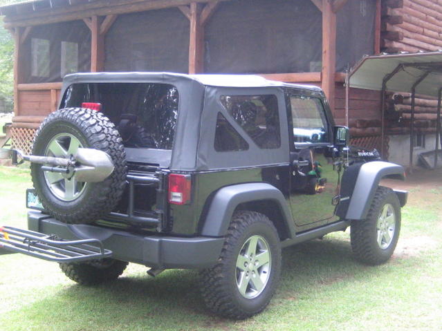

Old Oct 7, 2013 | 12:56 PM
Canada's Avatar
Joined: Nov 2007
Posts: 155
From: Ontario, Canada
Running a "true" 33" tire (255/85 KM2) on the stock 16" steel wheels, I have no problems lock to lock with rubbing.

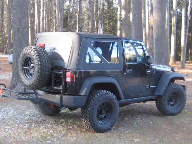

Old Oct 7, 2013 | 01:51 PM
jeepmojo's Avatar
Posts: 2,318
Likes: 12
From: New Hampshire
Default 33 in trail grapplers are
less than 32 like 31 /34 inches they look great and no issue trail grapplers and 16 inch b72 wheels
from dtd great prices shipped to your door Im pleased with the results I alternate the stock ones and these and no recalibrater needed Click image for larger version

ID:	503331 the trail grapplers give it a better stance however the stock ones are better for gas milage so with gas prices high I use the stockers lol
