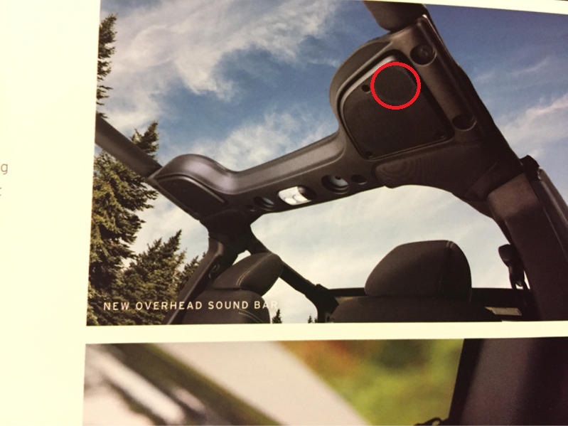

8 or 9 speaker on the 2015. 9th speaker is the sub. I believe there are tweeters in the sound bar as well.
Edit: from the jeep catalog, they are in the sound bar.

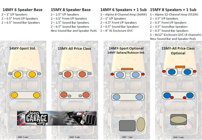

I do not know what you guys are seeing, but that is not the speakers. They're 2 tweeter in the sound bar. I had seen this on Jeeps' website somewhere prior, but couldn't find it today. Found it on another site though. 2x 6.5" and 2x 3.5" speakers in sound bar, 2x 3.5" speakers on upper dash, 2x 6.5" speakers in lower dash. A 3" speaker is not going to have a vent the size of a nickel; it would block a lot of the effectiveness of the speaker.

From the pic that spicoli posted it looks like they're right next to the other speakers.
