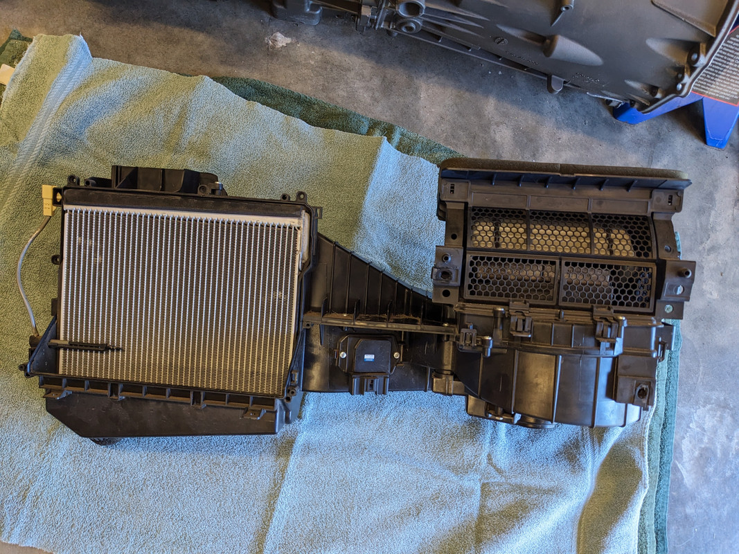

If it is the evap core, no. in fact, @icrashbikes has a thread on here with that exact issue and has torn out the entire dash to get to it. you can scroll down through this thread some to see the gory details.

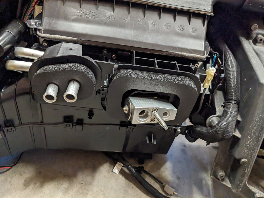

I wonder.. If you found dye on the inside of the firewall, there's really not much that can make that happen. The evap core is in there, but it sits in a housing that drains out of the cabin.
It does look possible for the expansion valve to leak and have fluid drip down the lines into the dash. This is the setup at the back of the dash:
That foam seal blocks off the AC line firewall pass-thru but there's no real seal on the lines themselves behind the expansion valve, just a plastic clamp. There are four seals in that expansion valve block that could go bad, two in the rear where a drip might roll down the lines, the back side of the HVAC housing and off the lower vents. Might be worth changing those seals out just to see. The expansion valve is accessible through the engine bay and it's like $20 with new seals so it's not a huge investment to rule it out.
