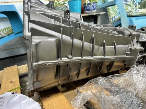

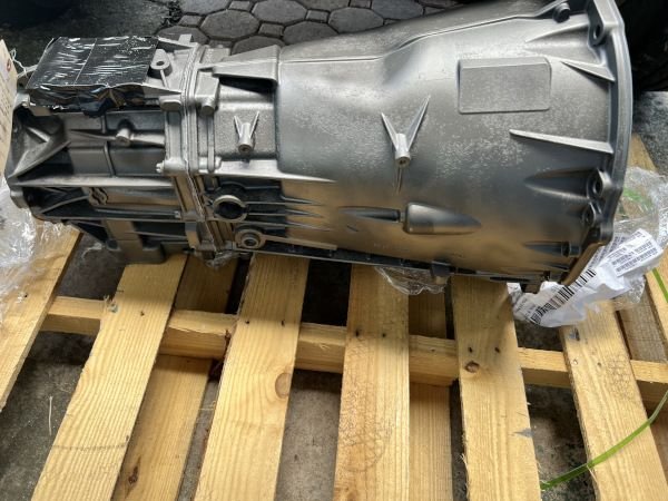

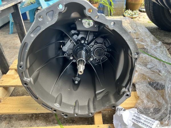

Transmission has been delivered.
Did a cursory look and man it is nice. Painted, sensors even that metal guide tube is on it (bummer because I will not be using it). If it functions as good as it looks, we're in business.
That was some seriously quick shipping. Ordered Monday, delivered to my house Thursday.
Again if it functions as good as it looks, then it was money well spent. I would not hesitate thus far to do business with High Impact again.
Some pictures as it looks coming from the company so that anyone contemplating the job and company can get an idea of what they would be getting.

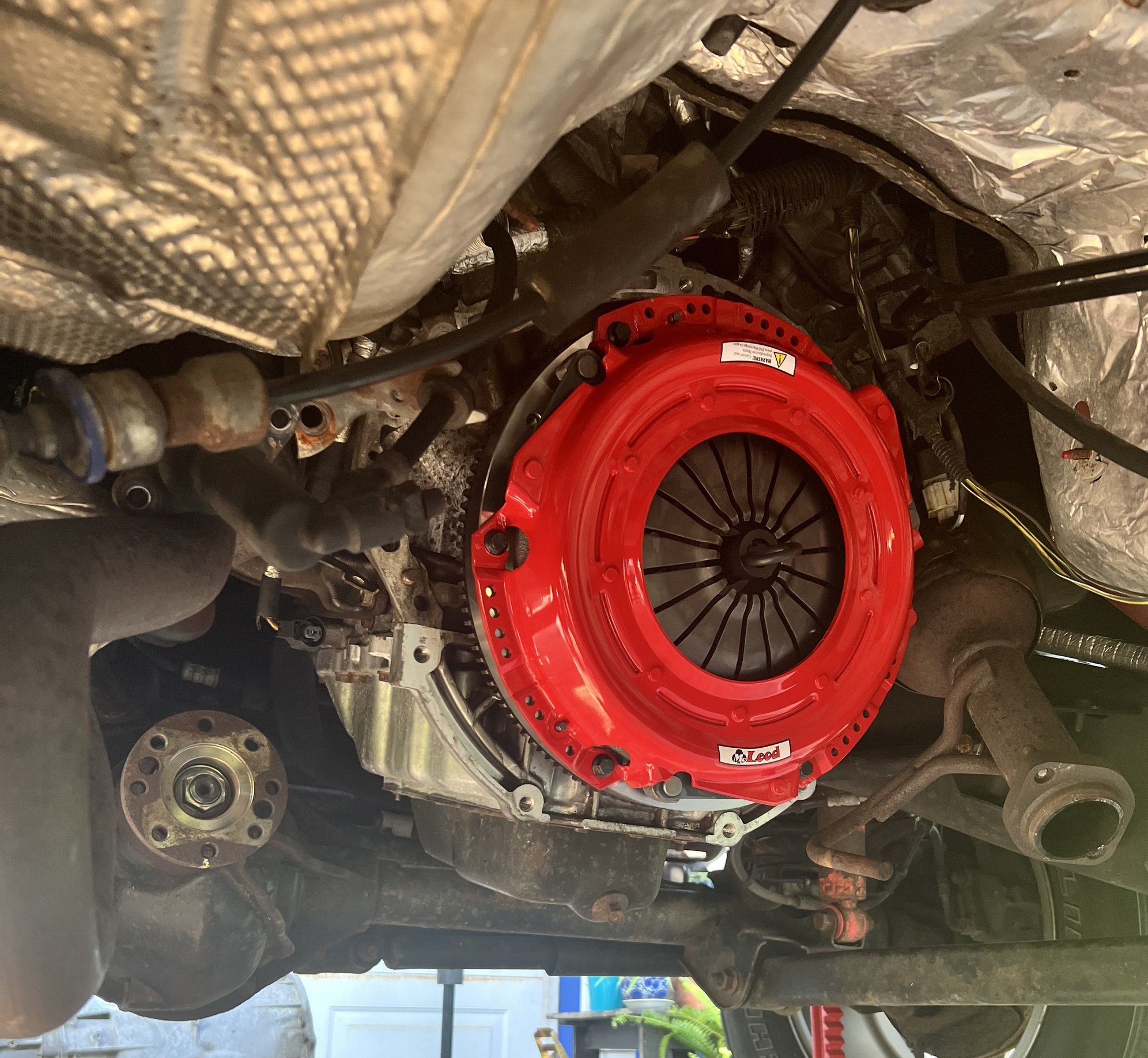

I am going to try to fix the exhaust flages. I got the new flywheel, disc and pressure plate installed. That max mass flywheel is a beast.

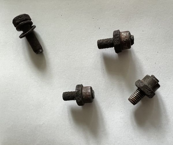

For those working on anything that ends up with broken flange bolts on the crossover, the nuts are indeed pressed in. They can be pressed out. I used a ball joint tool to push these out. What a PITA....

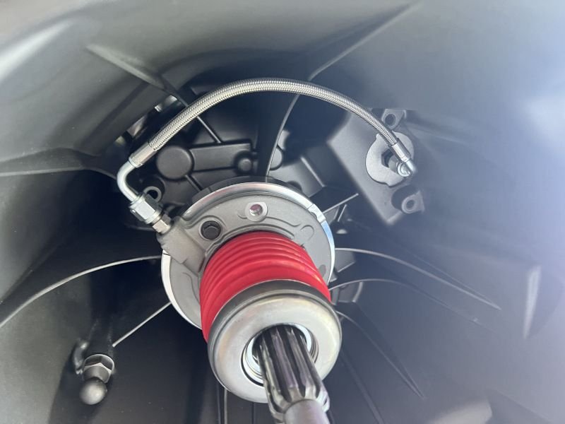

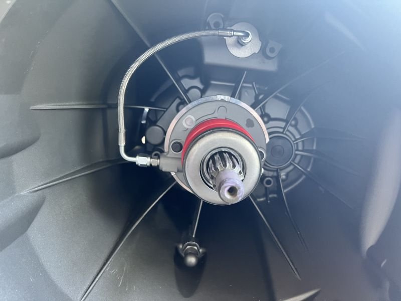

The McLeod hydraulic throw out bearing was installed. The studs were taken from the old transmission and installed on the new, this allowed the block off plate to be installed. Here it is together:

The McLeod clutch is real nice. Smooth and good engagement. The hydraulic throw out bearing works really well. I am glad I went with it. The pressure is easy and engagement is quick.
