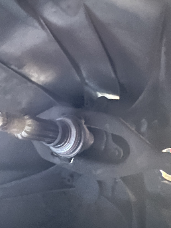

The front drive shaft has a torn boot on the CV. I was expecting that since I saw grease on the underside. It is torn all the way around. That means I will be replacing the drive shafts. Figure I will just do both. Thinking of going Adams or Woods.

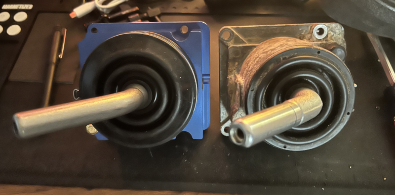

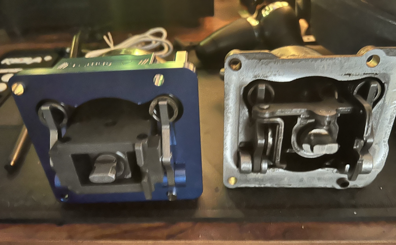

The shifter was removed. It has seen better days. The B&M is a much heftier unit on comparison.

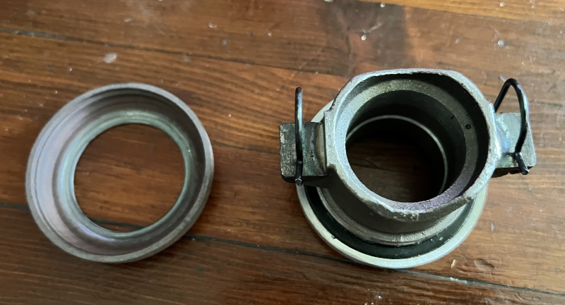

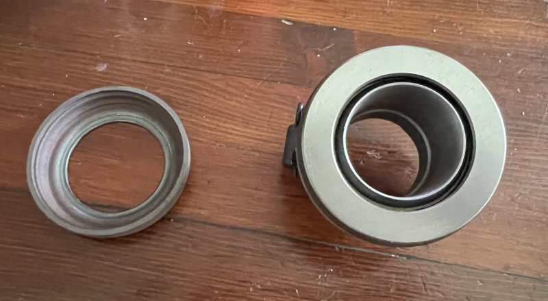

I need to remove the TO bearing, fork, retainer and guide tube. I also found why the TO bearing was making so much noise. Total failure. The cap separated from the bearing. Here is the cap sitting next to the new TO bearing that came with the McLeod Super Trail Pro clutch kit:
Funny part is, that new TO bearing won't be used. The fork, guide tube and retainer will not needed as well. The McLeod hydraulic TO bearing is waiting to take all of its place

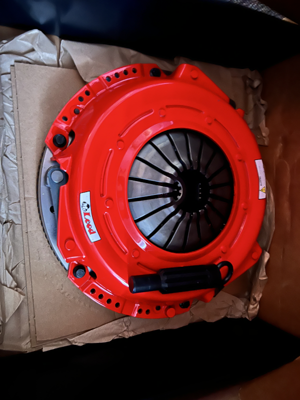

This will be used with the Super Trail Pro clutch kit I ordered. It has the pressure plate, clutch disc and max mass flywheel.
So finally progress being made. I will see how long the shipping takes for the replacement transmission and get it ordered. During that time I will remove the old clutch assembly and get ready to install the new one.
