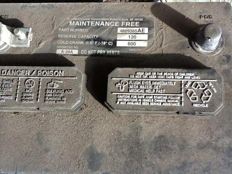

What's the make of the stock battery? Want to check if I'm still riding on it.

I cleared the codes...but the CEL stayed on. I went and got an AGM battery. I installed the battery. I checked the codes again. No codes but CEL still on. I started the truck up and CEL went away
Here' s a pic of the original..

So it is a Chrysler battery. Thanks Overland.
