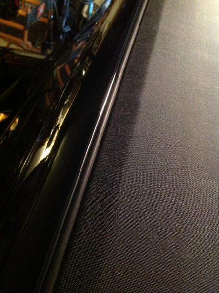

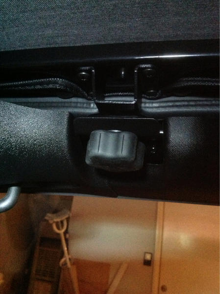

Old Mar 18, 2013 | 05:04 PM
8052949's Avatar
Joined: Nov 2012
Posts: 50
From: South OC
I mounted mine on a on 2012 2 door this weekend and it fit perfect. It looks like you got the header mounted wrong. Here's what mine looks like.
