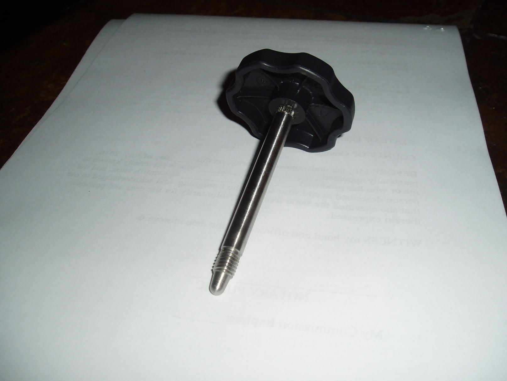

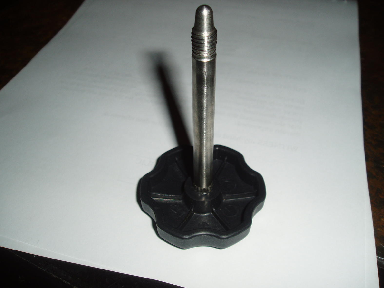

Not sure if we're talking about the same thing, but I'll include a couple of pictures and describe the dimensions:
Diameter of handwheel plastic knob 2.15" or 55 mm
Approx thickness of knob 0.5" or 13 mm
Approx diameter of knob's center shoulder 0.635" or 16 mm
Knob's center has hole to accept splined end of 0.312" or 8 mm shaft
Diameter of bolt shaft is 0.312" or 8 mm
Length of exposed, non threaded bolt shaft 2.6" or 66 mm
Thread size and pitch is 8 mm x 1.25
Threaded length of shaft 0.35" or 9 mm
End of shaft is an unthreaded taper; length 0.25' or 7 mm, tapering from 6 mm to 5mm with a rounded tip.
Bolt shaft is non-magnetic, appears to be stainless steel
Comments: The bolt shaft length does not appear to be very critical. The bolt shaft is designed to self-center itself as you guide it down the blind hole. A 3.5" (about 85mm) length stainless steel bolt with 8 mm x1.25 threads could work, particularly if you get some stainless steel washers to adjust the effective length. If you don't find a way to put a handwheel knob on it, you will definitely need a wrench to tighten or loosen the bolt
I recommend Ace Hardware if you have one near you. They have an excellent selection of this kind of material. You won't get much to pick from at Home Depot or Lowes.
Hope this helps!

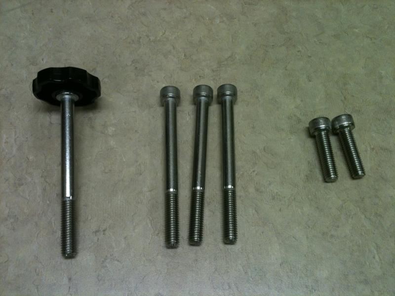

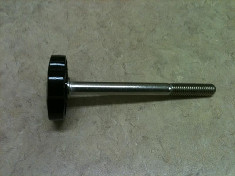

Default Thought I would post this here
Here is a solution...There is no need to go to the dealer and pay $20.00 each for these. Just call or go to your local Fastenal and place an order. All for $18.58 before tax. Ask for a discount, they can give it to you most of the time. It won't be a stock item, but they usually can have it within 3 days or so. I am sure McMaster-Carr would have these also but here are the Fastenal part numbers to make it easy.
6-M8 x 38mm Rosette Knob #11102957 $.6371 each
4-M8-1.25 x 90 mm Stainless Steel Socket Head Cap Screw #MS2580090A20000 $3.17 each
2-M8-1.25 x 30 mm Stainless Steel Socket Head Cap Screw #MS2580030A40000 $1.04 each

AWSOME!
They need to create a reference section on this site for information like that above.
