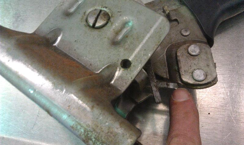

Yep. Broke mine twice! It's a easy repair and the part is about 50.
Here's a pic where mine broke.
Prob where yours broke...
Ronjenx has a great thread about the ebrake assy.
The part # is 52059887ad.

That's exactly the same place that mine broke. Thanks for the info! I guess I will go to Jeep and see if I can get the assembly.
Any tips on steps to get to it? I.e which parts need to be removed? Seems like maybe the side panel of the center console?
If I go to jeep; is that part number the one for that assembly?

Yes that's for the assy. U need to remove the four large torx bolts and raise the console to change it.
