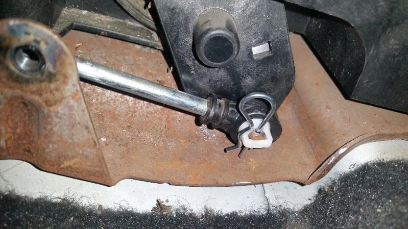

I bought a new bushing when ours broke. I also added a very small hitch pin to ensure it will not fall off again.
Attachment 591627

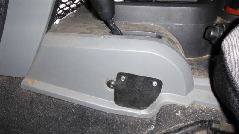

I bought the bushing suggested in one of the threads on this issue and it didn't fit. So I cut a hole in the console while I had it out (a real project that I didn't want to have to do again). I covered the hole and bought a spare OE bushing. You can use my photo as a guide to carefully cut a hole in the console so you can install a spare bushing if the original fails. You don't want to have to remove that console on the trail. The bushings apparently aren't all the same size from year to year is why the suggested bushing didn't fit.
Name:	DSCF1851 (800x450).jpg

Welcome. The reason I got the OE bushing was because it was ready at the dealer and the hitch pin was easy to get at a supply store. No tinkering, no guessing and making a new solution. Just making the factory solution better.
The first one lasted 7 years, which is decent. Just remember to not force it and if it doesn't go into a gear you may need to put the transmission in neutral or roll slightly.
