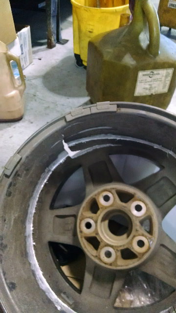

Happend to me also. It tore a hole out of my AEV Beadlocks rim
