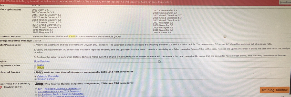

Thank you Mr. T. Yea the price difference doesn't seem worth it I guess to take a chance on this. I asked a jeep shop how much they would charge to do the cat and o2 sensors by me and it was all in about $1800. It's only $300 in labor. The parts are killer on this one.
I also gained access to a software similar to AllData called Identifix. This software allows you to put in the year and make and model of the vehicle and then the trouble code and it tells you the different fixes for it and how others in the "identifix community" of mechanics have solved that issue also. I'll post some screen shots.

It's a really cool software

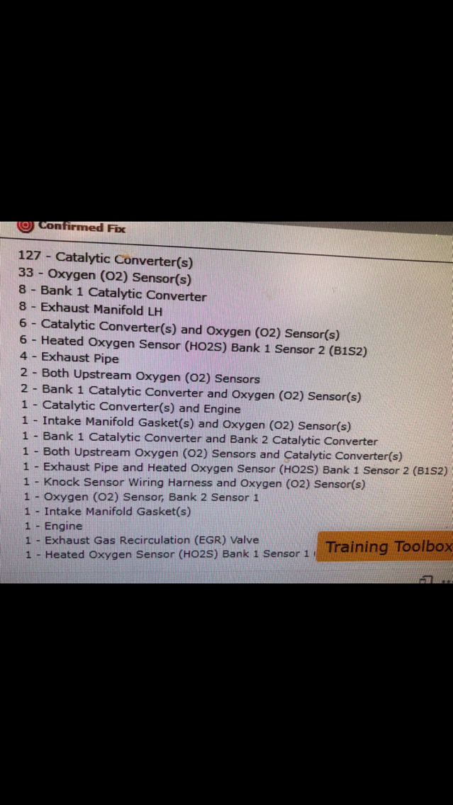

Shows some other info

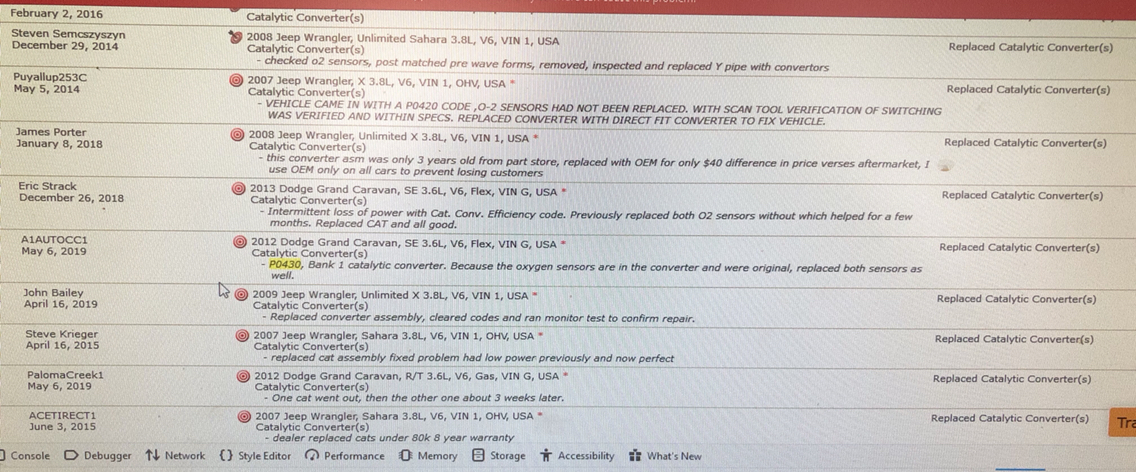

Last one that shows the confirmed fixes
