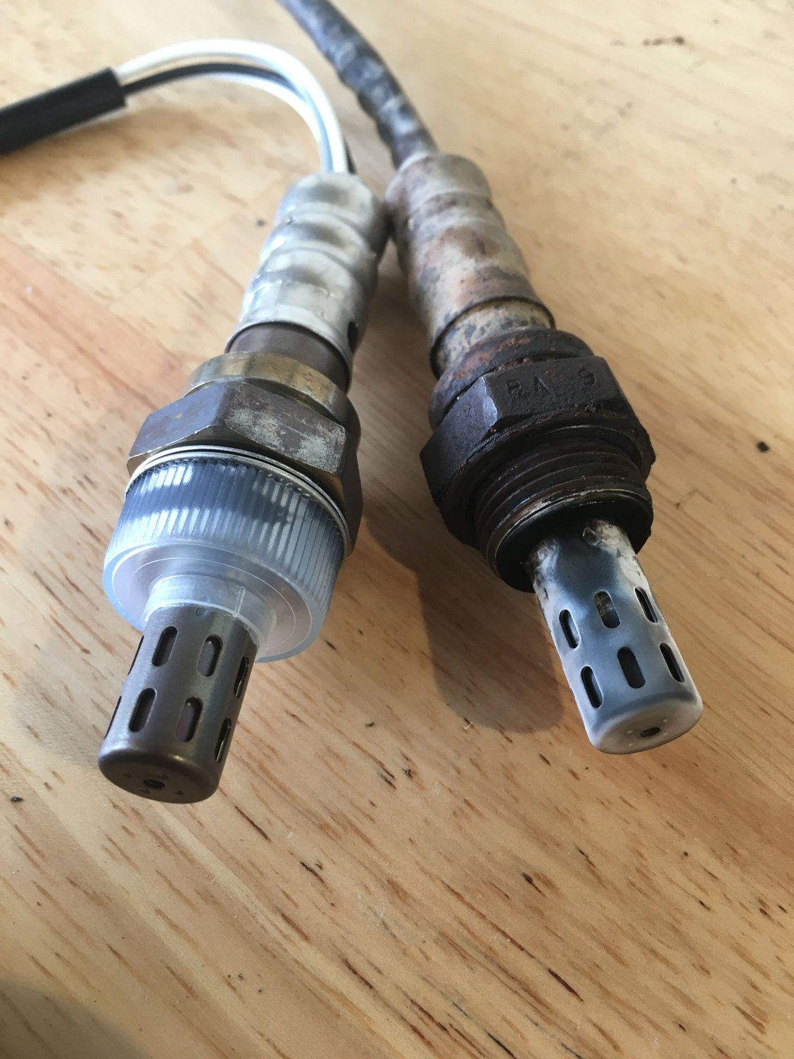

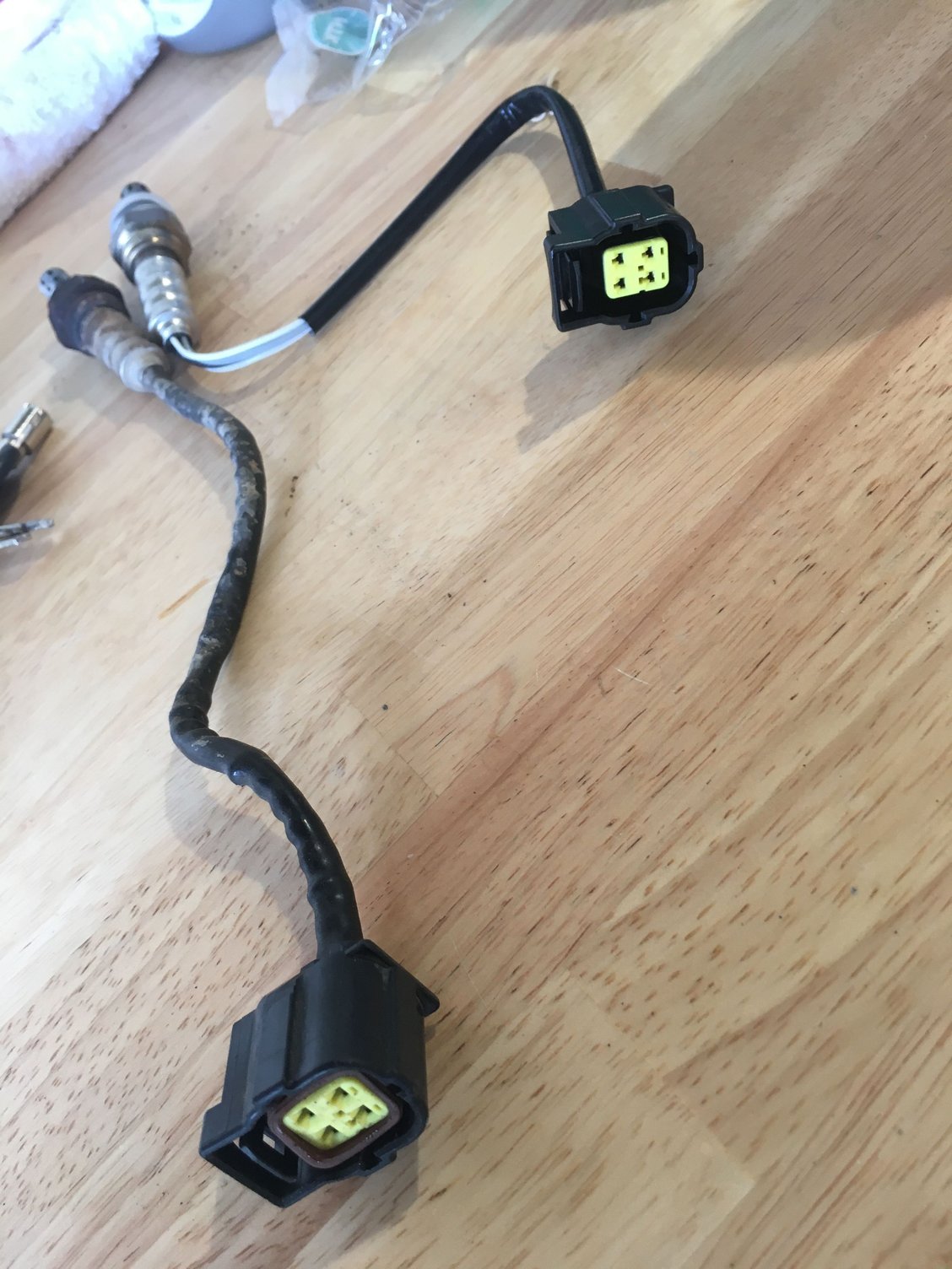

So for anyone reading all the way though this, I decided to just replace the sensors in Bank 2 (drivers side) and I also decided to just go with the NTK sensors rather than Mopar. My theory was to spend as little money as possible up front on emissions especially when I have 2 years to play with it before I am due for inspection. So i hit both sensors with PB blaster for like a week as advised by this forum and got a O2 sensor socket from Home Depot for $11. Both 02 sensors were a breeze but the down stream I did have to remove the transmission skid to access it easier. Very easy job to replace the 02 sensors at least on bank 2 but I would spend the time hitting it with PB first for a bit. Here are some pics of the sensors so people can see. The down stream was almost a match while the up stream was slightly different.
So far no codes at all. I'll update if this fixed me up. I would normally get the cat efficiency bank 2 code by 2 or 300 miles.
