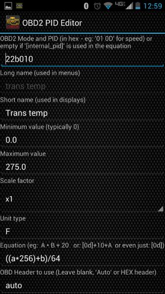

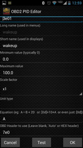

I used JKphotoshoot's advice and help & these setup parameters worked for me:

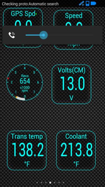

Third pic is my readout #s after a short ride @ 35-45 mph for about 4 miles. Seems accurate comparing to my FlashPaq results that I've always seen.
Thanks again JKphotoshoot!
