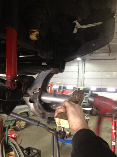

^X3. I'd rather over-build than bend them and have 5X the cost to fix it. Hell, I installed gussets even before I put my 33's on!

You do not have to pull your ball joints. Have them alternate welds from one side to another welding no more than a inch at a time. Let cool between welds. Very simple.
Old Dec 8, 2014 | 01:47 AM
rooster1976's Avatar
Posts: 457
From: Amarillo,TX
Here's pic
