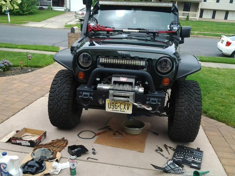

I just replaced my front cover and am doin an arb rear soon too, but both my d44s had just rtv but I installed a paper gasket WITH rtv alsoClick image for larger version
ID:	464817It's just an El cheapo gasket from any parts store but it works like a charm! U can see it sitting under the jeep in the pic
