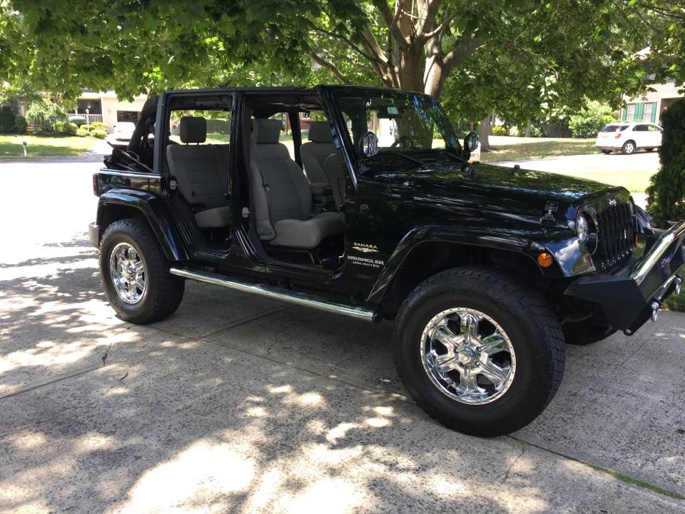

I went with the Olympic safari mirrors that mount on the door hinge $49.99. Click image for larger version
