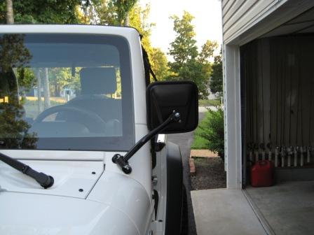

I did this to solve the problem
http://www.quadratec.com/products/13011_02.htm

Dude that is sweet
This may be a dumb question but are those the factory winshield bolt holes?

I followed the link and it said it was for a YJ
so like someone else said, Did is bolt to factory windshield bracket hole?
If so thts next on my list!

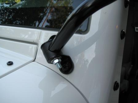

not trying to hijack and probably this should be in the modified section. but because of request.....
yes they are for a YJ and yes they are the stock bolts.
they are to be mounted like this on a YJ, but they stick out just a little and you need to add shims (washers) for alignment of the mounting holes.

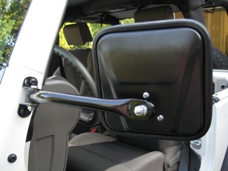

mounting in this position keeps them tucked in but you loose some visibility.and I only have the driver side mounted, still working on the passenger side. in this position keep the mirror bolt lose and
tighten the angle pieces then the mirror arm bold. the the mounting holes on the windshield bracket are little narrow, you will see....
