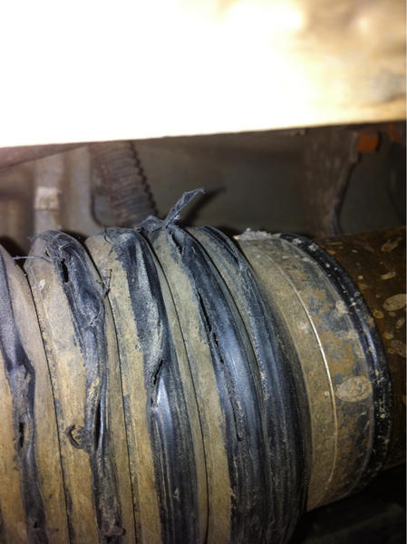

I had my drive shaft boot shred and my jeep is all stock
