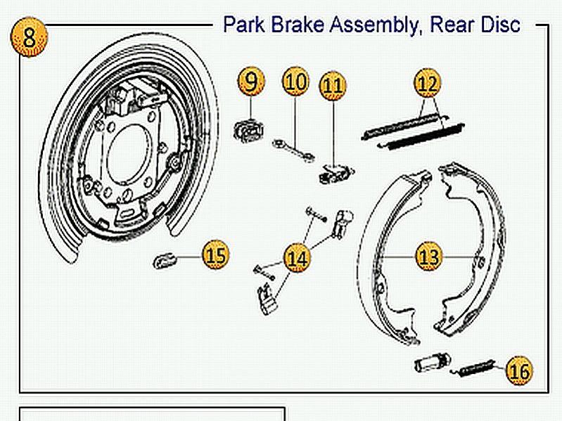

Old Jun 16, 2011 | 08:57 AM
rokklymer's Avatar
Joined: Jun 2010
Posts: 487
From: Fonthill, Ontario
guys I just got through redoing the whole ebrake assembly on my 08 Rubicon. It is NOT self adjusting. I don't care if you drive it forward, backward or sideways. It is NOT self adjusting. It must be adjusted manually. My wife has a 2011 and I checked hers and it is the same thing.
If you recall in the older vehicles with drum brakes there was a lever that was 'rockered' when reversing that would actuate and move the spur gear therefore adjusting the drum brakes of the vehicle. The emergency brakes in the Jeeps is not like this. There is no lever for the spur gear therefore it does not self adjust.
Here's a diagram of the ebrake system;
Name:	E Brake Assembly.jpg
