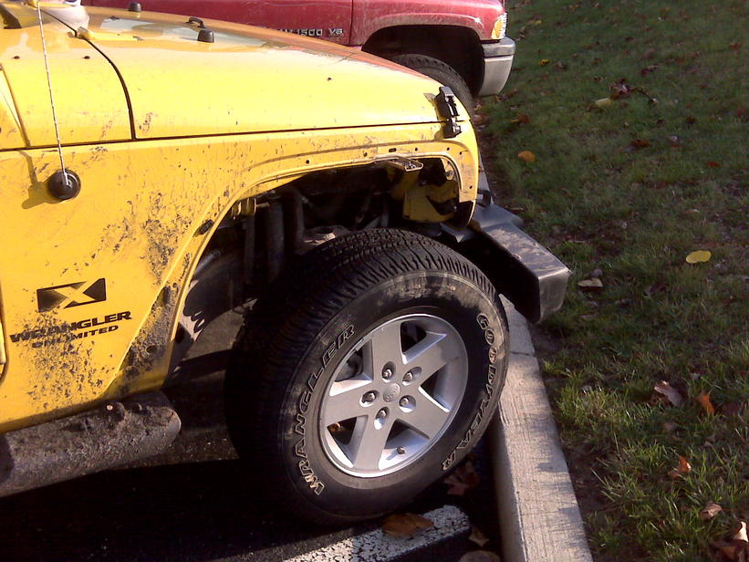

I had the same problem. Once with the Jeep in the driveway. I forgot something, and when I returned, I foudn the Jeep in the middle of our street. It was a few feet from my neighbors truck with a car coming down the street. Also my son was in the Jeep.
Second time was at Rausch Creek. We stopped on a decline to look at the trail. My buddy was leading in his Dodge truck. When he looked back, he saw my Jeep rolling towards us. It was stopped by his back driver's corner. The Jeep's passenger's side fender peeled right off. Again, my son was sitting in the Jeep playing his DS.
I took the Jeep to the dealership, and they could not find anything wrong. Luckily I found a stock fender set on eBay for 3/4s of what the dealership wanted for just the one fender assembly.
